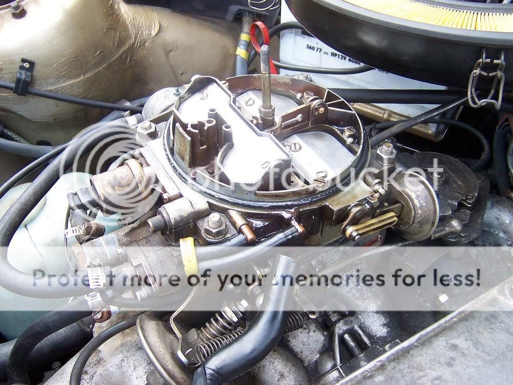

What do you mean? First of all I don't want to change anything, to try keep it all original, if I need to change the carburetor I will get one exactly identical buy in good condition. So you are implying it's the carburetor? How do I know if it is a 'solex' will it be written somewhere ?
Re: (Car turns off) the Car shakes when engine is on
Solex carbs are an inherently poor design. Where the spindle mounts, for the butterfly, the carb body wears out and so you end up with problems such as those you describe. They also have airways that corrode. The Weber & Dellorto carbs have the spindle sat in a bearing which is why they don't fail in the same way. Unless you can find a new Solex, in an effort to retain originality, you'll just end up with the same problems again. The auto chokes are also notorious for causing problems. The Weber conversion isn't something that would detract from your cars value. In fact, quite the opposite. Your car will run far better, be better on fuel in normal driving and produce more power when you give it the beans.

Solex 4A1
I had a new head on mine, renewed the manifold seals and had a tune up. The car ran like shite ever since then. Unless you do a full re-build on one of these, their a lost cause

I have the same carb and the same engine. I just rebuilt mine, bought the rebuild kit from W&N. The guys are right, weber is the way to go, however, I f you want the original carb the rebuild kit was £50.00 or there abouts. there is a BMW service manual down load on here that is Fantastic! My carb is now running fine. If your car is giving you greif at cold start but not on hot start, chances are the cold start aux air slide is stuck. very common. I had to source a spare one for mine as the original was completely seised. In the picture above, the air slide is to the left of the yellow adapter and has two water pipes and two screws holding it in. with the engine cold, take that off and see if there is an air gap between the brass slide and the housing. if not then this is a good place to start :)

also , the 24mil bolt next to the air slide is the fuel inlet. there is a screen on the end of it. see if that is full of crap.

Hi guys, thanks for all the answers I really appreciate all your help!!!! Regarding the spark plugs the mechanic changed them all. Please keep in mind every one, that I am not exactly a very good person with technicalities, however the photograph of the carburetor is exactly like mine, that much I realized :D . I would like to update the status of my car now, as I just returned home and it stopped right outside my drive, I tried starting a hundred times but no way in hell it will start !! :( Can any one please link me to a full detailed step by step explanation of how to rebuild the carburetor? Also, I think there is indeed something wrong with the ignition system something seems to be going on in there. If I removed the distributor cap and spray some WD-40 and close it, should it make a difference? And do I have to remove all those wires stuck to the distributor? Because I won't know how to put them back.
