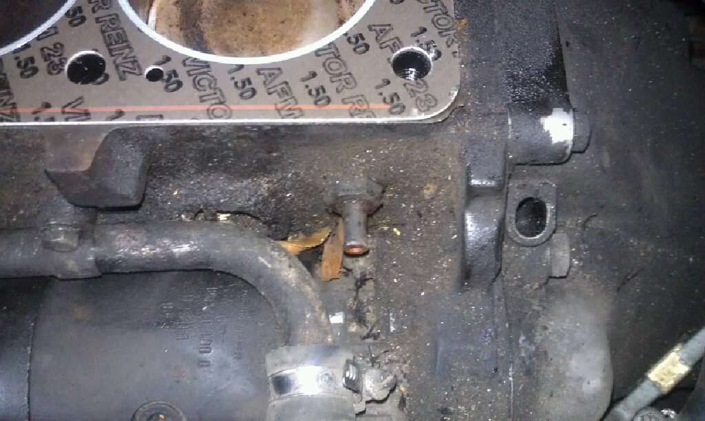

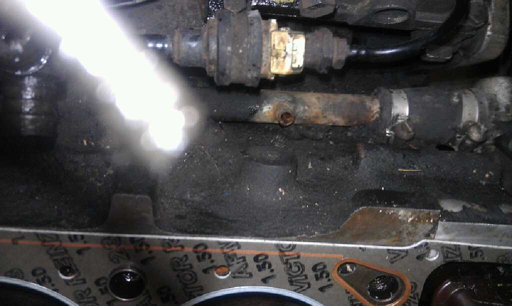

Help here .. I have a 1983 m10 e21 320i .. i have removed everything for the head gasket replacement .. have al the gaskets to replace everything i think . however there are 2 hose connections i have not found where they go..
one on the back of the head closest to the firewall.. sticking out of the head and the other seems to be a water hose coming off the back of the water punp line headed to the heater..
Any help here would be appreciated

Here are the pictures of the 2 hose locations i was talking about .. anyone out there ???
appreciate any help here..

the one is actually on the block no ton the head its a small hose, the one from the back of the water pump is as well

here are the pictures i hope ..lol
Hope you can see them and give any help on where these last two hoses go..

do they go to the throttle body? some throttle bodys have a coolat heat bit in them....
Re: Head Gasket replacement
the small outlet closest to the front of the car runs to the underneath of the throttle body. The one closest to the firewall runs to the side of the throttle body.
