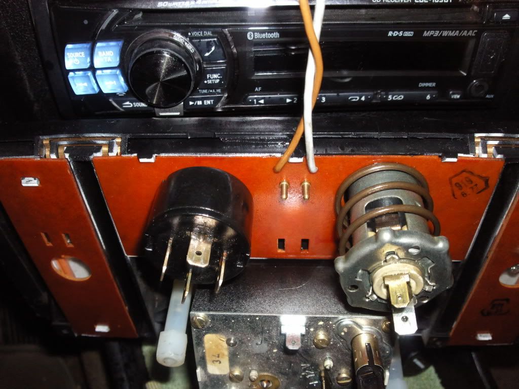

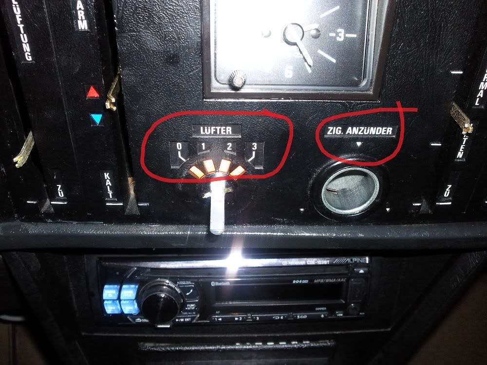

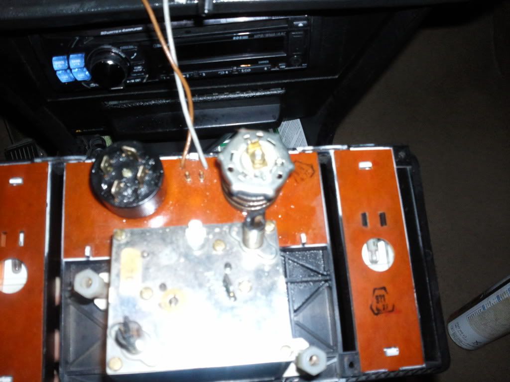

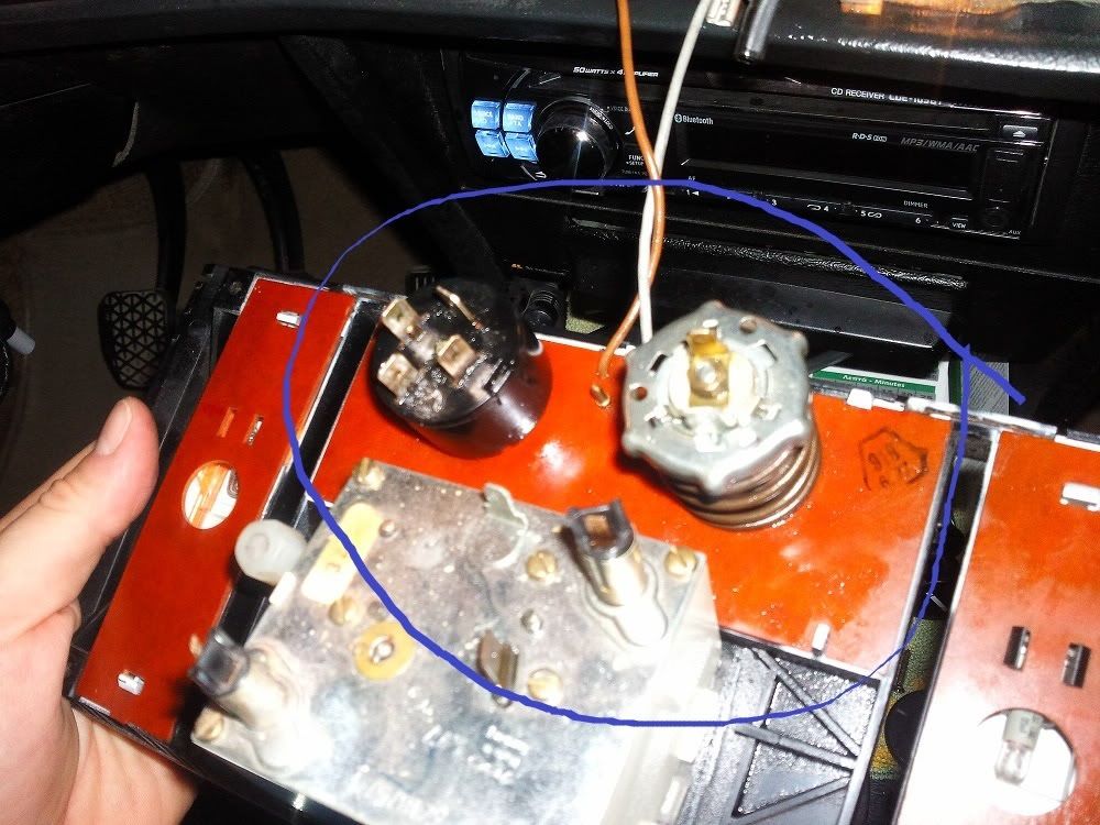

Ok, fresh update here WITH pics...! So plz HELP!!!
I managed to remove the console
Still I couldn't find out how to remove the orange coloured plastic part behind the not working bulbs...Or maybe it was just I who was afraid of breaking anything?? I used some contact spray for everything in that area, and put it back in place...And then a miracle happened: The lights came on!! However, the "miracle" lasted just about a couple of miles, as after some potholes/bumps, lights decided to go for a nap again... :(
Anyone who can tell me how to open that damn thing behind the lighter and the fan switch in order to put my hands on these bulbs and their contacts???
Here are the pics:

I mean, my big prob is not how will I remove the orange part, this is obvious, but how to remove the lighter+fan switch rear parts...I can't figure that out...

Dunno about the lighter but for the switch undo the large nut at the front

But, I did that...How else would I be able to remove the console part? If you look at the upper picture, the switch is already removed...!!! The rear part is the trikky one...as well as the lighter rear part...!!!

Perhaps I'm seeing different pictures here but it looks to me you removed only the knob (you knob :lol: ) the nut is still there, around the spindle the knob goes onto

Oh, I think I NOW got it...Thanks, I 'll give it a try...
Still remains the lighter issue, though...

If you look at the back of the lighter, you see the backing plate (the one held by a spring) has a bayonet style lock. I guess if you press that one slightly and give it 1/8 turn counter clockwise it'll fall apart...
