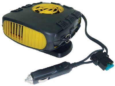

as shtoopid as it seems there is this...instant warmth from the salmon n trout outlet!....on egay.
Re: more warmth
My mrs had one of those. It was like an asthmatic mouse breathing on the screen with the added risk of it catching fire.
