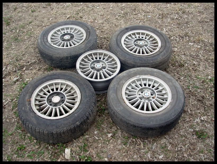

Do you mean these ? if so are they 13'' or 14'' ?
Jay :read
Re: E30 wheels on E21
Yes. 13'' are OE.
