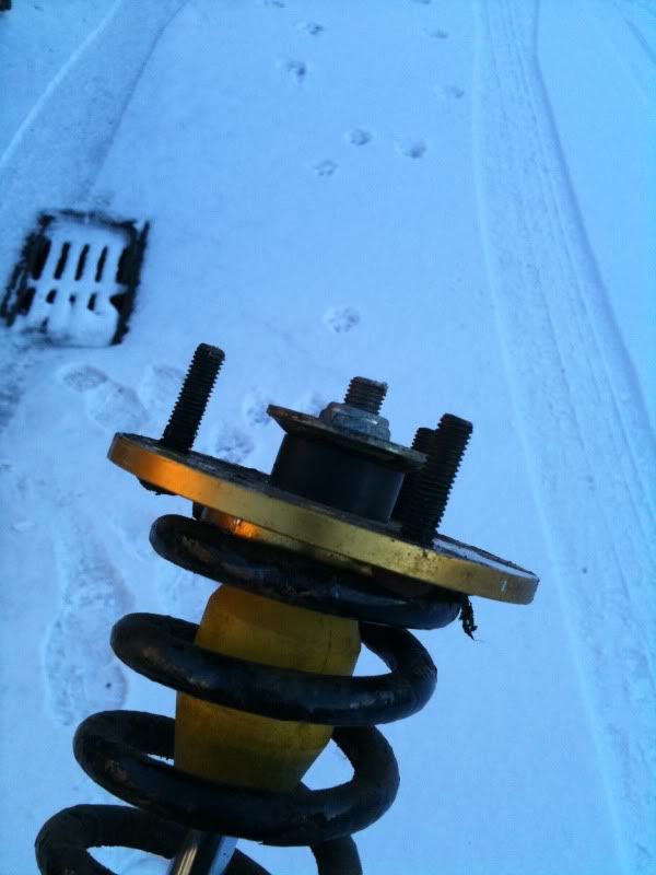

This?

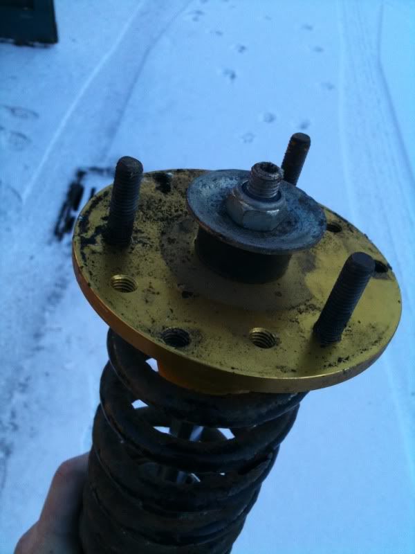

same as them pics. see where the nut is that is what hits the shelf i can see the dampner rod when i bounce the rear of the car its quite hard explain ill see if i can post a video of it happening
Re: suspension
As I said it's exactly the same problem I had with this car (my old track car) and we had to strip out the damper to repair & modify it. You can see where its torn through the rubber top mount.

Wow! That must have been a big pothole. :eek:

Same thing. You need to strip out the rear shock and replace rubber top mount.
