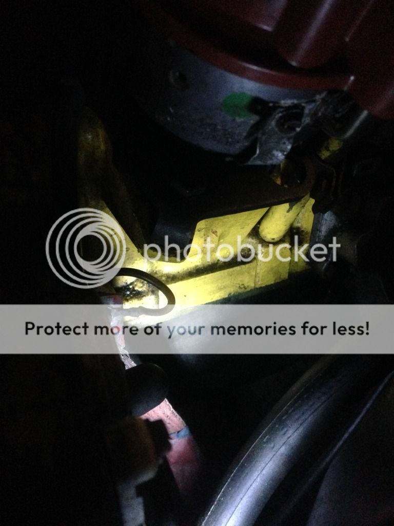

I've looked hard and im scared the code should be here -
so, is the code supposed to be there? if so, i need another option for discovering the displacement!
OR am i looking in the wrong place?

The code should be over there indeed. Try to remove some of the paint and maybe you can read it then.
The cylinderhead has a code also (original BMW) which ends with the figure "200" for the E21 and the early E30. If it says 731 or 885 you have a cylinderhead most likely of a E30.
In the dutch section we have a topic with the engine and cylindercodes. Page 3 has the summary.
http://www.bmwe21.net/forum/viewtopic.p ... 1&start=30

Thank you very much!
That confirms I was looking in the right area!
Im very much hoping there will be a number under the paint!!

I'm now one step closer, i have the code from the engine, took about 10 mins with the sandpaper but i revealed
7255321
how do i get the displacement from this?
