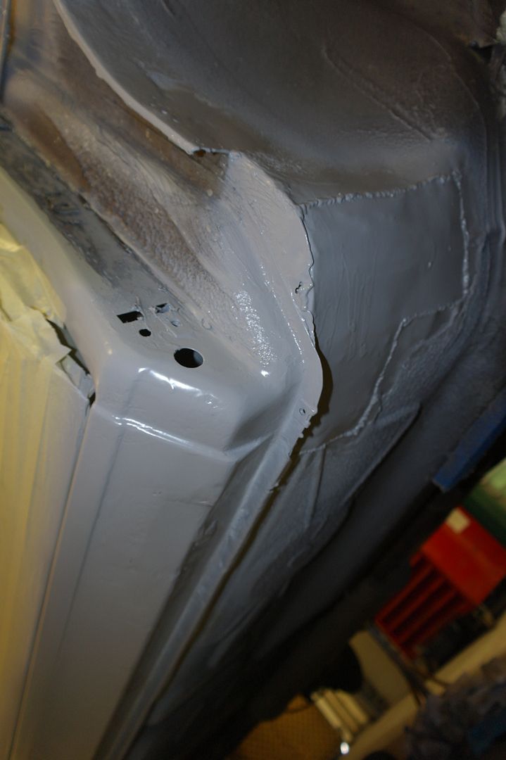

Photo time line of the clean up up to date. not show finish, but on a limited time scale.

Before
After: still needs 2" dropped at the back to level.

Quite some progress! But eh, leaving this as is?

Post by pandemonium001 »
weight saving holes/ cooling ducts for the brakes :loll
now your making me feal guilty, but just needed to move things along after all the important bits where done.
