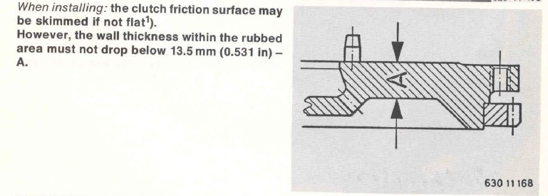

Re: 323i flywheel minimum thickness
This is what I could find in the factory manual
Post by 3771489 »
...more from same manual:
