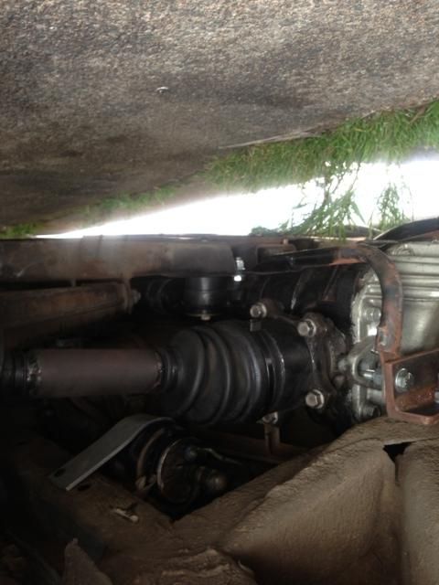

so i started to fit this, it was a big job
subframe removed and both diffs together
the axels were different of course, in length adn diameter
custom axels were expensive so i wanted to make my own,
many hours on a lathe got me to here, you can see i trued them up, drilled a hole through the nissan axel, and turned down the bmw axel, machined them very finely and extremely close for an interference fit
then using a diamond bit i drilled a hole through where both shafts join and pressed in a hardened steel pin, plug welded both ends of that.
then back to the lathe, i preheated, welded and post heated about 30 mm of the bmw shaft to build it up to the larger diameter, turned it down super smooth, then made an interefence fit tube 6mm wall thickness to press over the top, i preheated the shaft, welded both ends and let cool in a bucket of sand for 6 hours
finished item
this is the nissan dif fon bmw subframe test fititng before axels were welded
almost finished, the rear mount was temporary

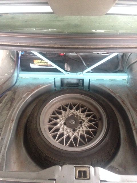

had to cut the boot floor and make a strong mounting point for the rear of the diff
the rear end works great, but it was alot of work
