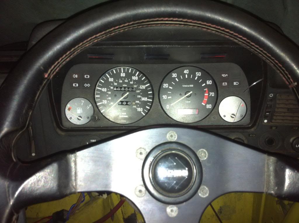

Mines running an E24 electric speedo in the binnicle with an E30 diff sensor mounted near the driveshaft. I got a 9 tooth chopper wheer laser cut to fit the cv joint bolt pattern.
Just need a live and earth to the speedo
One signal wire to the sensor and one earth wire on the sensor.
Calibration is a bit out. Shows 77mph at 70mph from the satnav.
Mileage over my europe trip was:
Actual mileage - 2395 miles
recorded mileage - 2552 miles
so just 6.55% error, where the regulations are 10% overread for accuracy.
This is running 205/60/15 tyres. It would be more accurate with larger diameter similar to teh E24.
