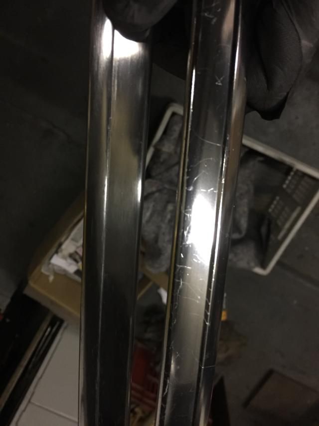

Well I started a few days ago trying to tidy up all my trims as I can not put them back on scabby after a re-spray
Now I've started I carnt really stop but regretting it as it's such a long process
Anyone else done them all or just bought new
This is one of the better condition trims not to many scratches I only used a multi too polished and some polish I had which I think is not to bad a out come

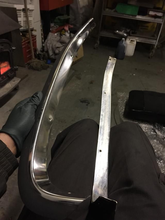

But one of these 2 was far to do red and scratched I didn't get a starting photo of it but this I just
Wet/dry sanded it from 180,240,800,1200,1500,2000
Then on the polishing wheel 3 differnt wheels and 2 differnt wax here is the out come not 100% need to re flat and do it again. But I think it should look good
First just flat with sandpaper

Now here is after first attempt on polish wheel
