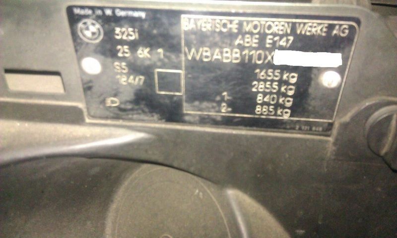

My e30 325i automatic cabrio misses it's identification plate, which dissapeared after a paintjob, several years ago. So I ordered a new one at BMWs, but they onley have blanc ones. To get the right numbers on mine, I need to know what the numbers and codes stand for, so who can help me with that?

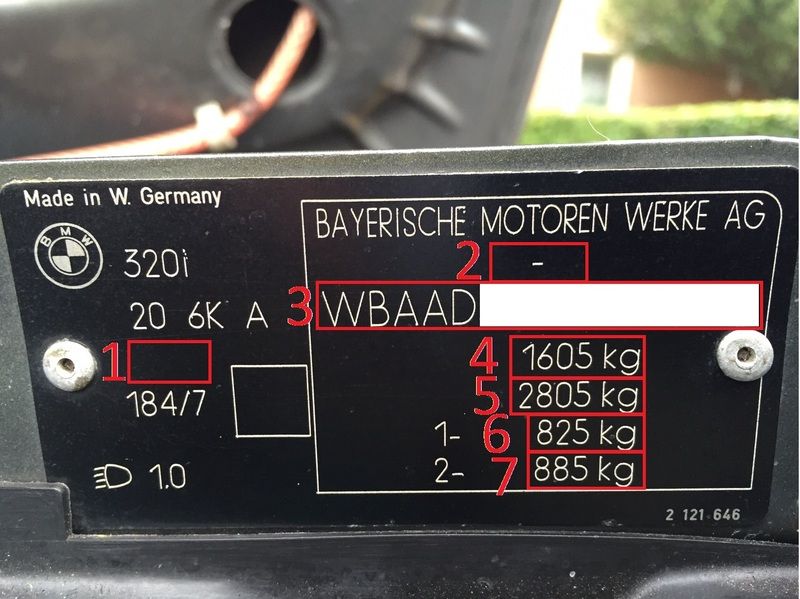

This one is of an e30 320i:
this one is of an e30 325i:
whats the meaning of numbers 1 till 7?
1= ? 320i says nothing and the 325i Cabrio S5 of 85 what does this mean?
2= ? the 320i says - and the 325i cabrio ABE E147 what does this mean?
3= Vin number
4= ? empty weight??
5= ? empty weight + max trailer weight??
6= ? ?
7= ? ?
Who can help me?

Thanks! I have rhat list already. Its not the vin I'm after, actually nr 2, above the vin is the only one I still don't know. Who knows what that code means?

Not sure, but on most models this is not filled in. It may be reserved for country specific approval for mods like the German Allgemeine Betrieb Erlaubnis (ABE). This is required if a technical modification is done that deviates from the original roadworthyness approval. Normally this is done afterwards and noted in the vehicle registration only (to stick to the German ABE example: in the Fahrzeugbrief). This depends on the country, in Holland there is no such additional approval, mods are evaluated on an individual basis during initial and annual checks.
So if this would be on the VIN plaque this would mean that a deviation from the original model approval specification for that country was implemented during production. For example if 16" wheels were factory fitted while the model approval was only for 14 and 15" wheels. That would be my best guess.
