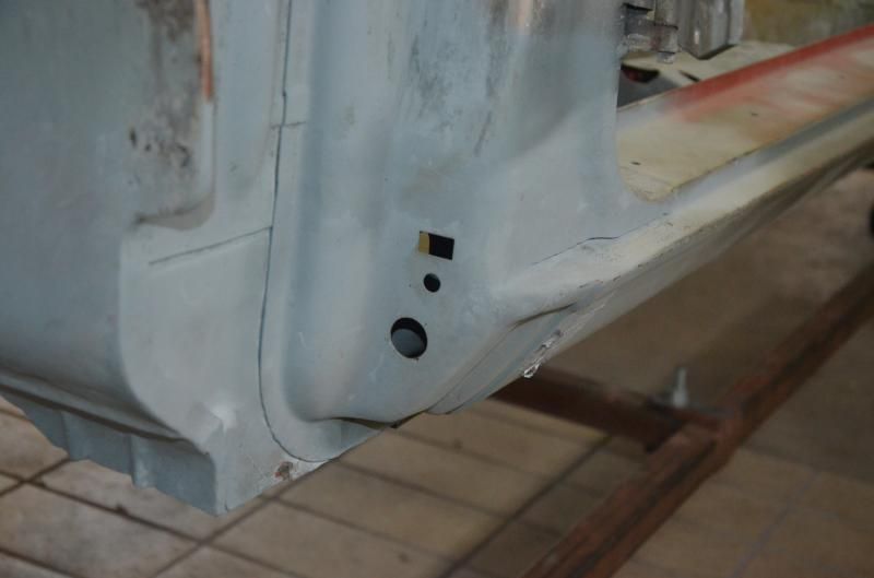

The front drainpipe comes through the A-pillar and then into the sill.
Sometimes the E21 has holes at the front of the sill (just behind the fender) that would be the best place to let the hosedrain out i think.

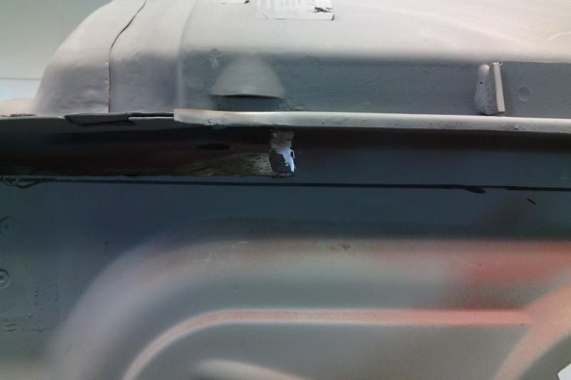

I've just inspected that very issue myself today. I'm going to reposition the exit of the pipe to exit into the wheel/fender well, will drill a hole if required as doesn't appear to be one there on mine. I also couldn't see any drain holes on the actual sill, appears the water just sits in there!?
Posts: 19182
Re: E21 sunroof drain pipe into sill redirect
I`m gonna use this hole. The sills have a couple half moon like shaped openings near the flange under.
