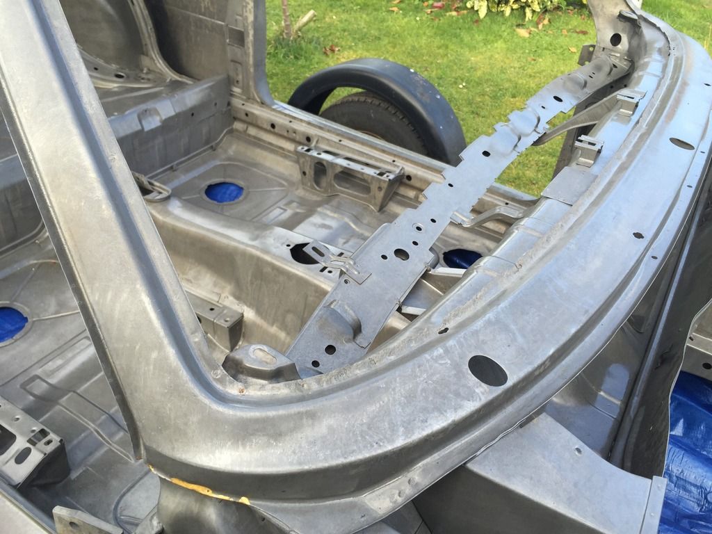

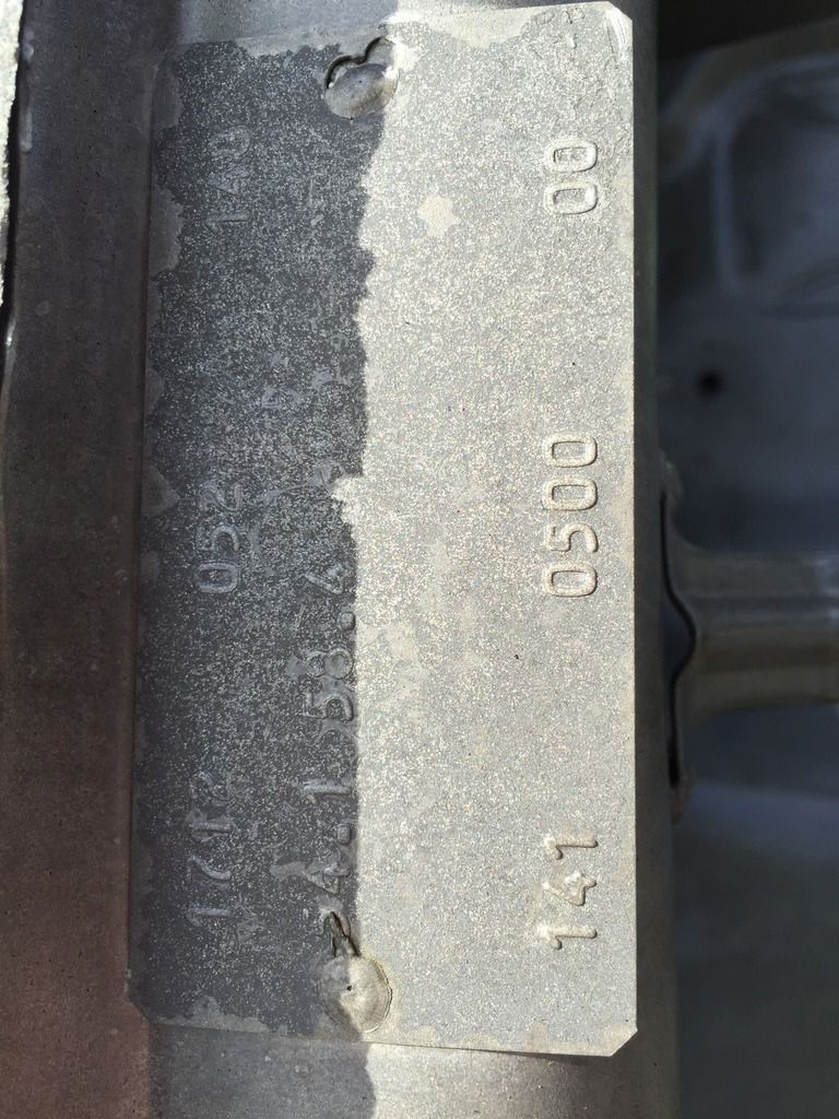

Duracel79
Posts: 816
Re: 316/323 Body Shell Differences
Post by Duracel79 »
You can see it in this picture very close to the windscreen:
and a close up:
Regards
