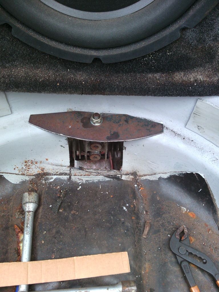

You will need to remove an exhaust hanger and you will need to cut out a bit in the spare wheel well.
This pic is from when i was mocking the hole thing up.

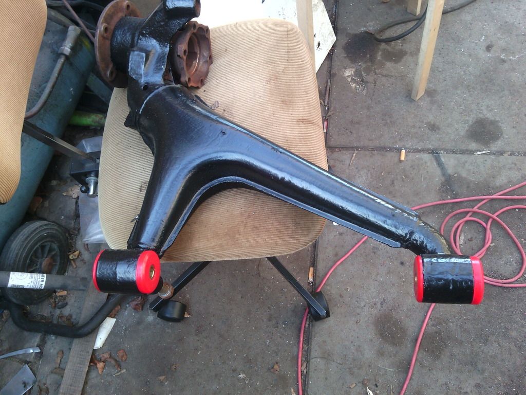

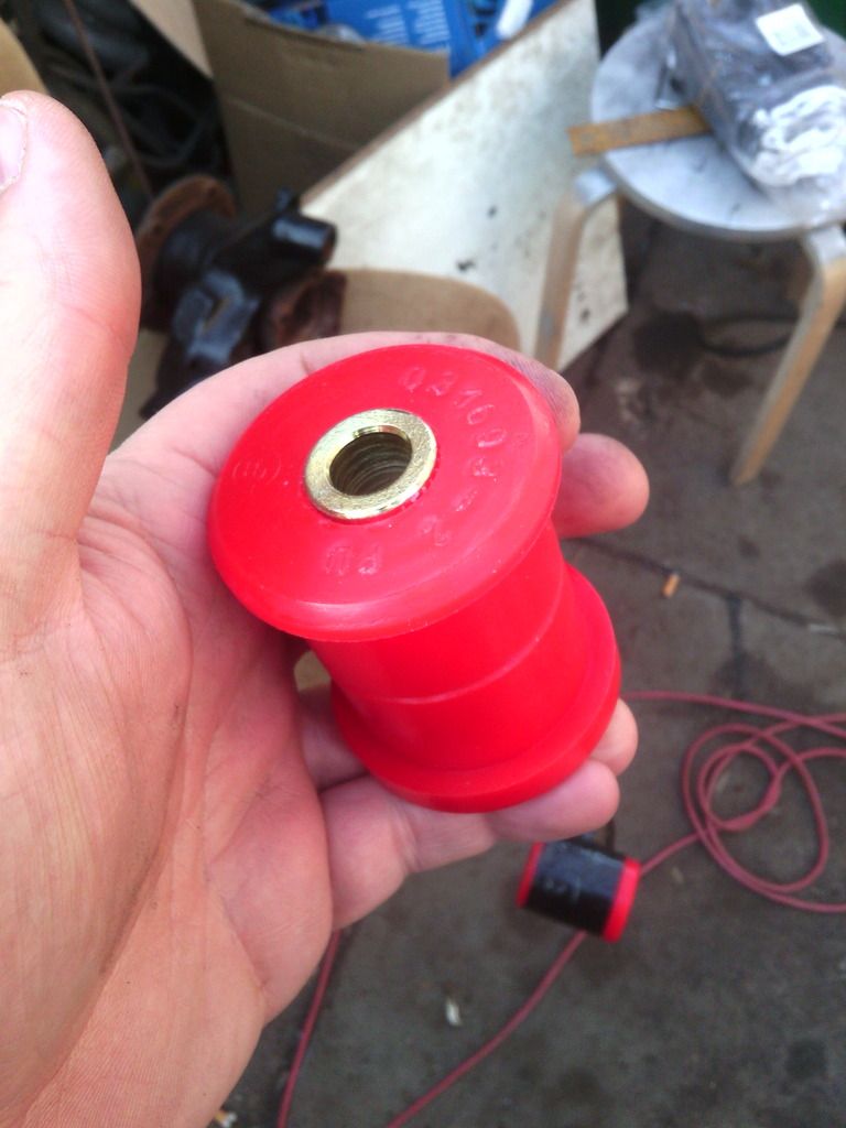

[/URL][/img] Also i can mention that E34 polyurethane bushings will fit the E29 sway arms
