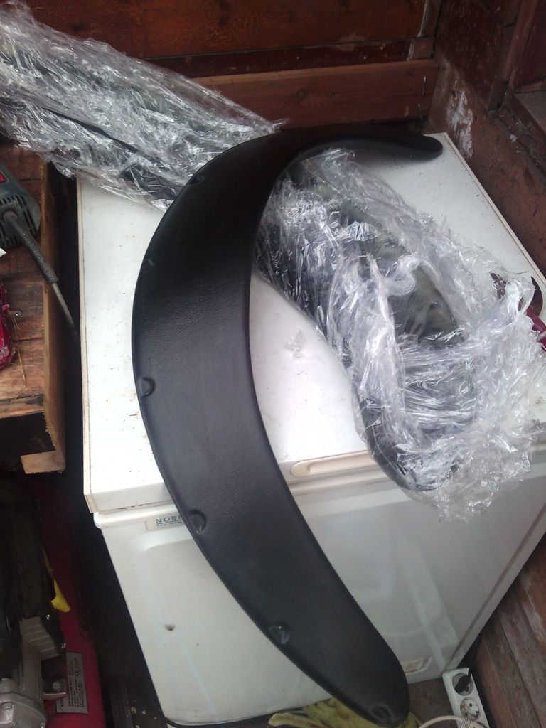

The main disadvantage to this is the e28 wider than the e28 and you will need to use a high offset wheel , approx 45, or install fender flairs. From what I have been told it's about 30mm per side.

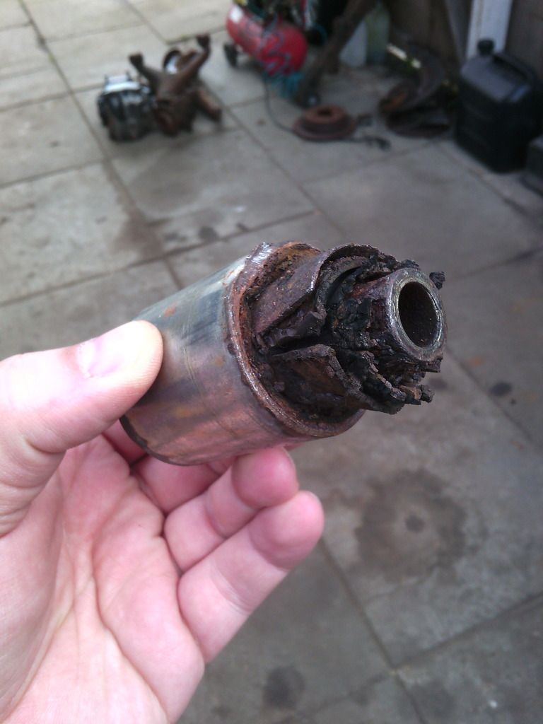

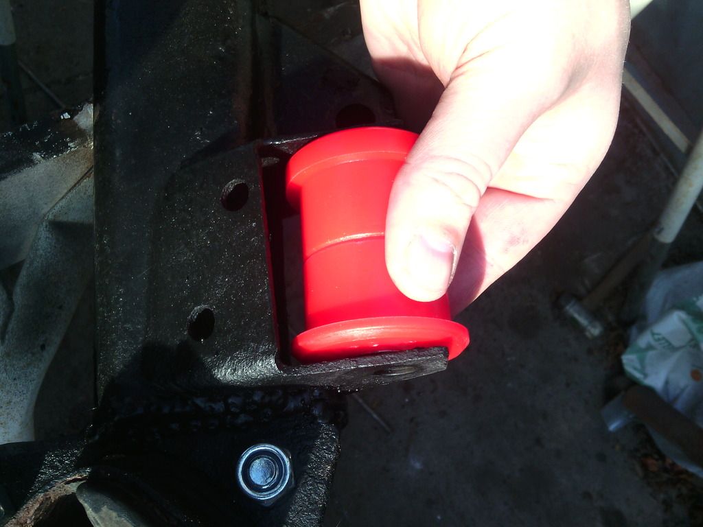

Unless you buy a practically new E28 rear frame you will want to change the bushes in the sway arms. Those suckers are stuck like a SOB.. E34 polyurethane ones will fit, and are cheap on Ebay. I needed 18 tons of pressure to get this one out!
With best regards
RUH

Ahhh those are the rear bearings out if a m5. Some have a cylindrical bearing rather than a rubber bushing.

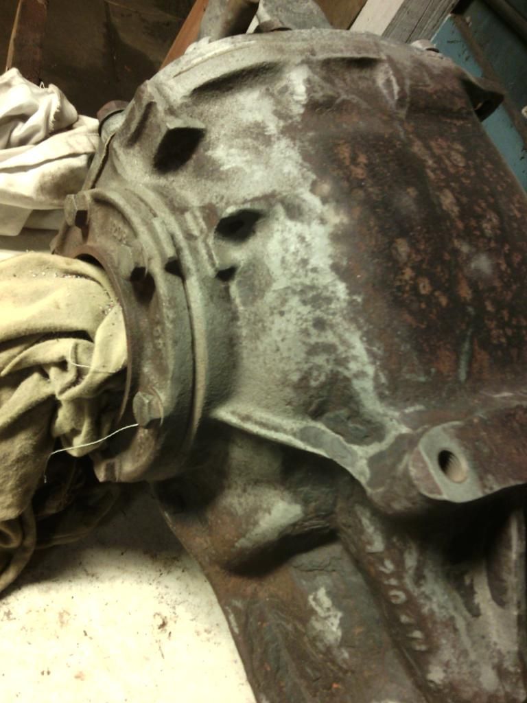

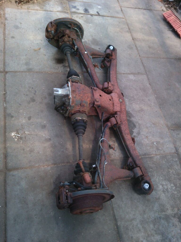

But anyways, i got hold of a E28 525 rear complete with disc brakes etc. It had been lying in some guys backyard for some time. The bonus in that aspect was that it was not covered in oil and dead groundhogs, instead it was very dry, and pretty rusty..

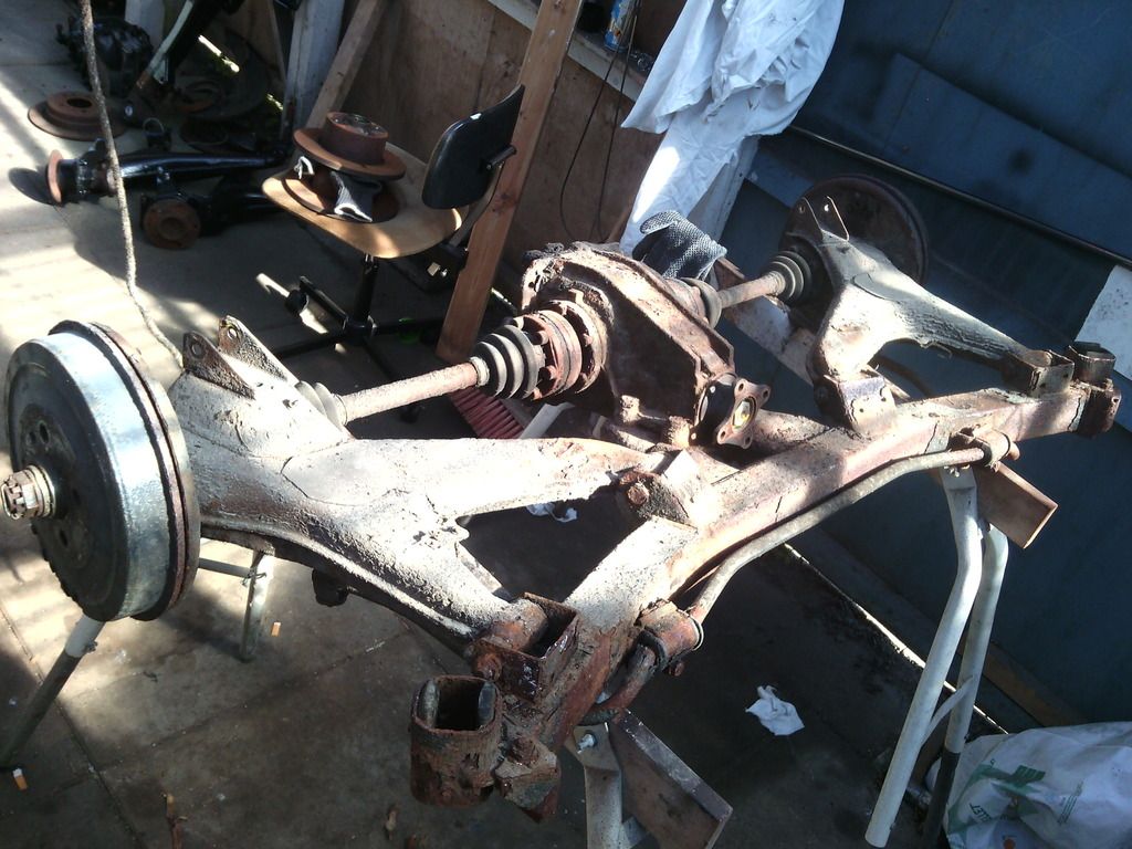

First things firt, i removed the old E21 one:

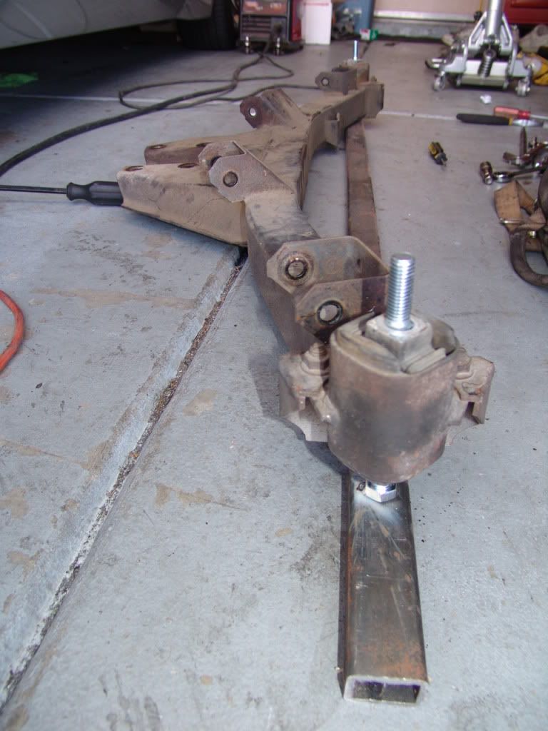

The only thing you need to keep is the brackets of the cross member. They can bolt off and they can as they are not the same height top to bottom from the bracket, you can actually turn them upside down. On my car i did that because i discovered that the E28 rear sat pretty low to the ground.
I do not take credit for this picture, but this is one way to do it before you cut the E21 brackets off.

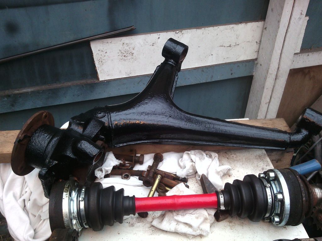

I chose to take my E28 rear totally apart and media blast it lightly before paint.
Spend a good amount of time cleaning everything up. Please note that i do not use the drum brakes on the E21, i have hooked everthing up to hydraulics (including the handbrake), so i only use the disc brake function. I have no idea how the E21 and E28 are in regards to the drum brake function!

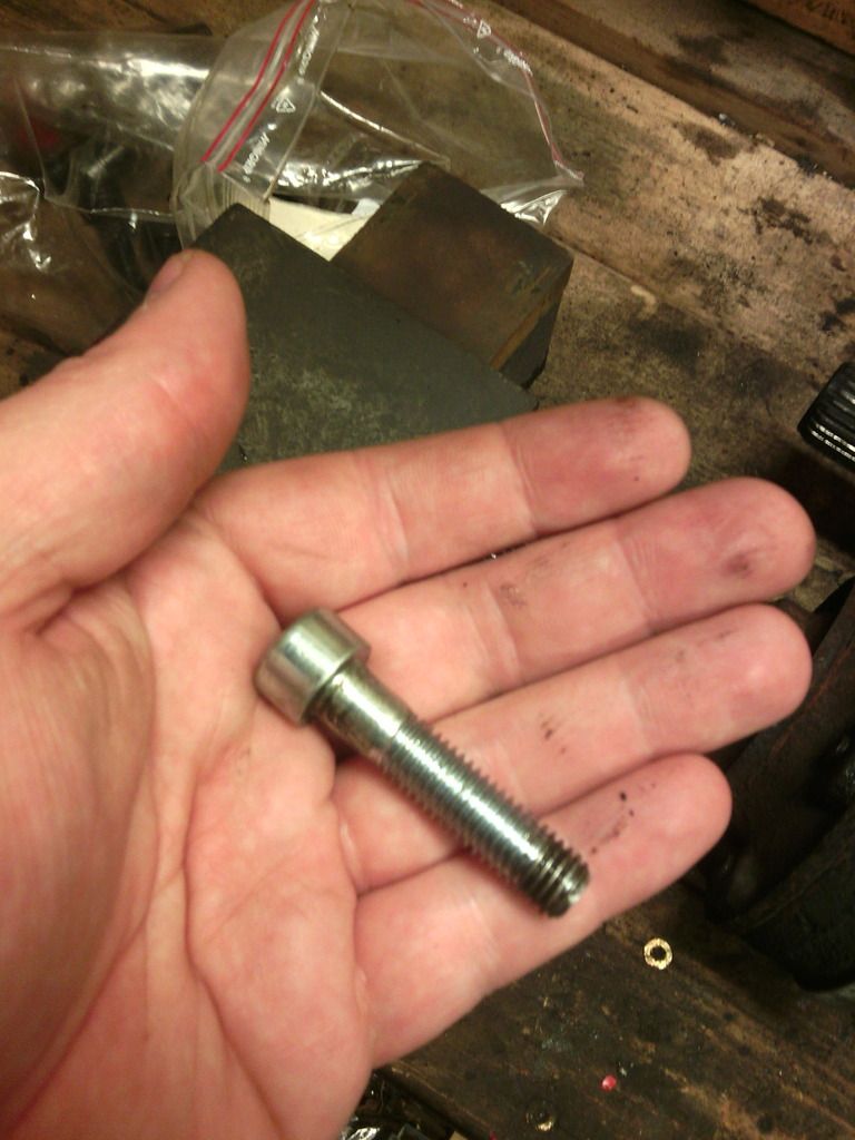

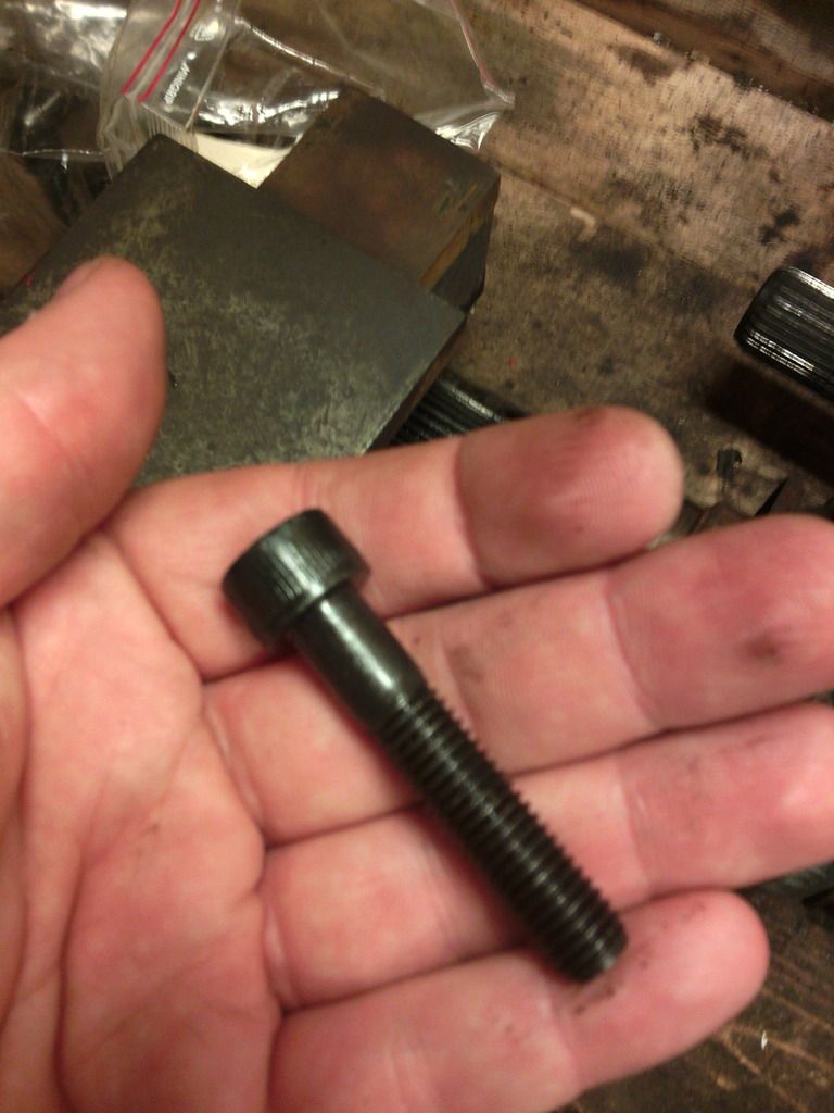

I also renovated the axles, an here is a word to the wise about those bolts!
When you buy new rubbers for the E28 axles please observe the new bolts that follow the kit. Mine was nice and shiny but they where too short! The threads barely had a hold of the hub!
Also on the head of theese new shiny blingbling allen head bolts are stamped the quality of the bolt. The new ones was stamped 8.8 wich basically means they are softer than butter in the sun! If you are into the ANSI standards of bolts you would know that theese new bolts are about to be a major doodoo.. I am already picturing broken bolts in the diff..
Fortunatly new ones in the right length and in a kick-ass quality is easy to get from any parts and accessories shop. I got theese hardened steel ones instead, stamped 12.9.

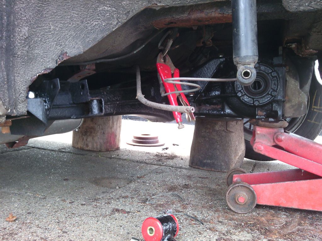

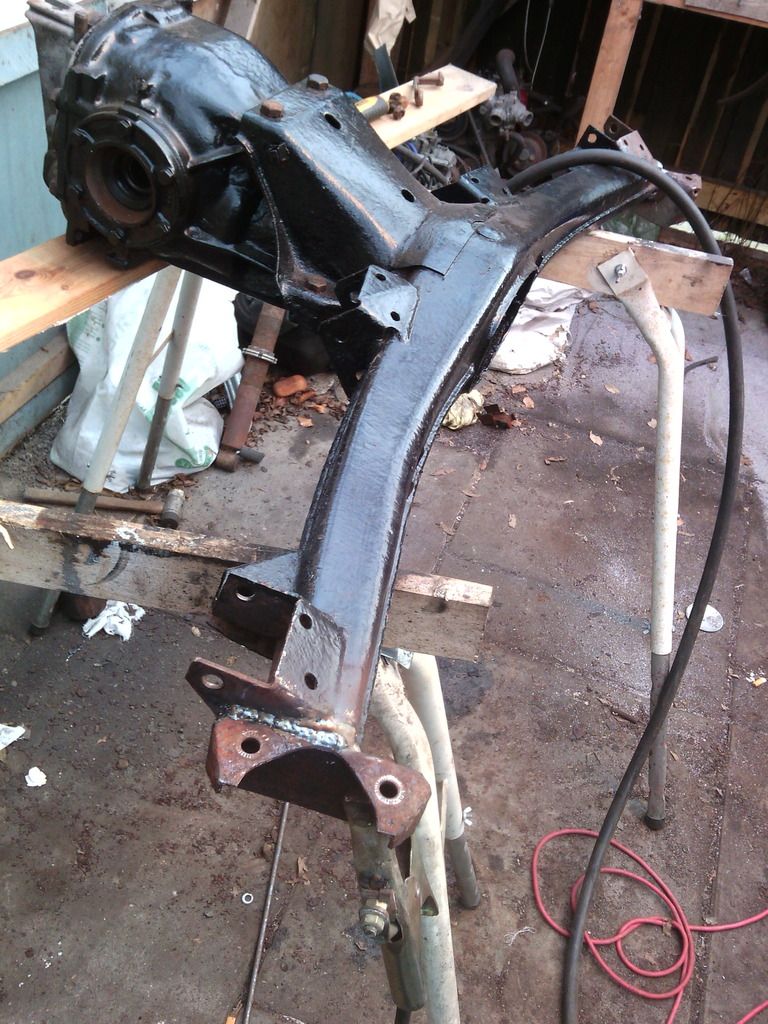

Next step was cut and weld. It seems that one the E28 frame the E21 brackets needs to be level to the sway arm bracket.
Polyurethane bushings from a E34 is a straight fit.
Test fit on the car

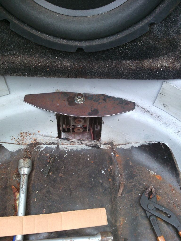

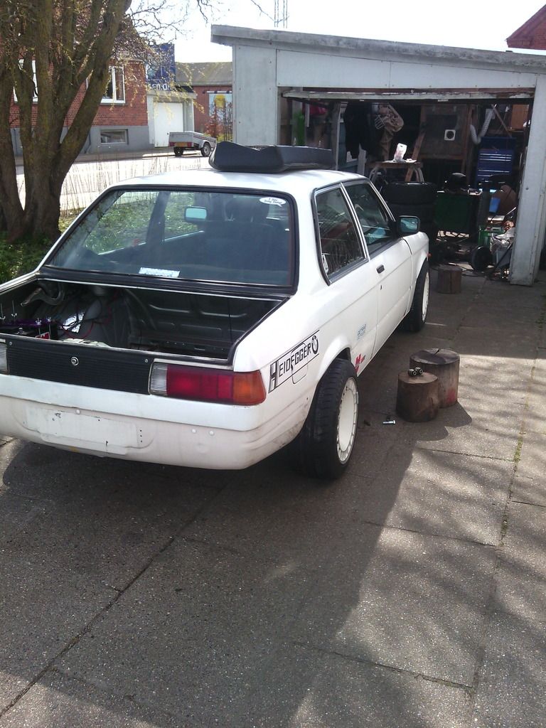

Once again there are more than 1 way to do this. I chose to use the E28 rear cover for the diff, and that means i had to cut the spare wheel well and make a mounting bracket. That meant i had to remove the originale bracket for the E21 diff.
The part in red line is the cross member of the car, the yellow cross indicates the original bracket for the diff, and that was just cut off.
In the trunk i needed to make a cut
And make some reinforcement
I test fitted some 7 series wheels to see if everything was straight.
And that was practically it.

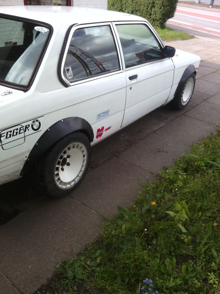

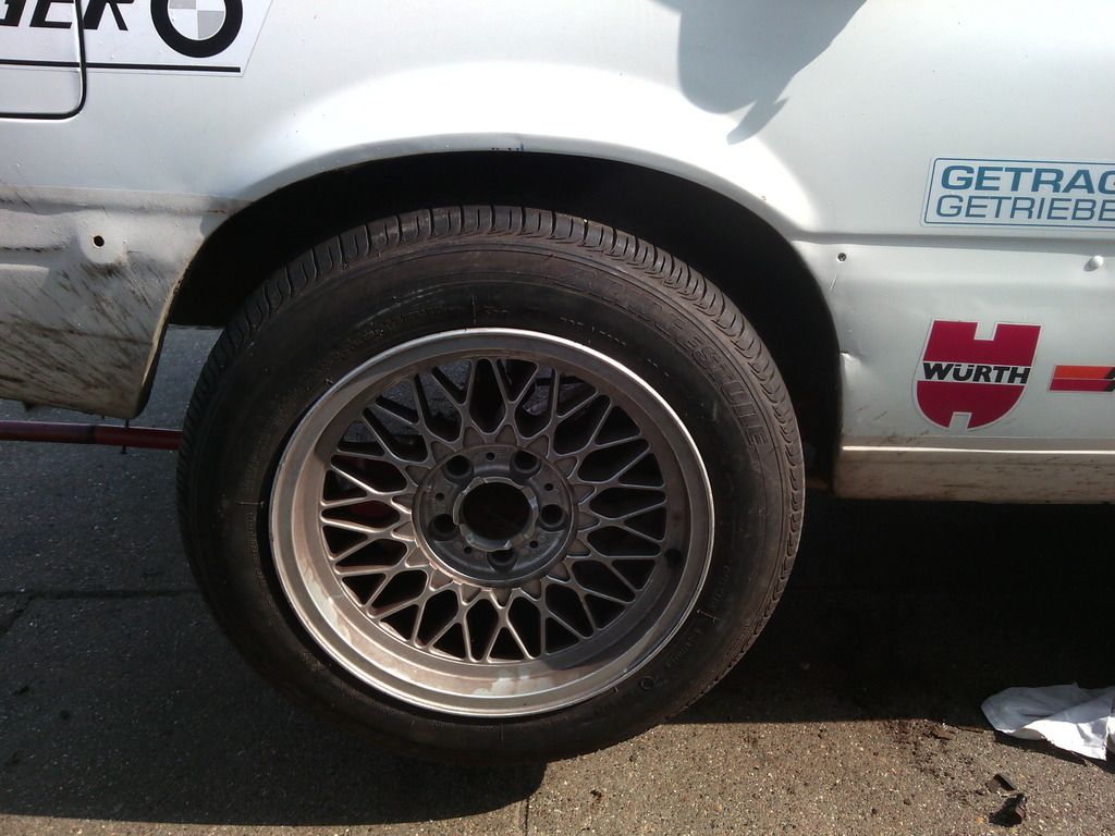

The wider track is a issue, and the wheels on the pic are 8x15 ET0 wich is not helping at all.
I chose the easy fix for this problem, and i figured that the E21 is very oversteer happy anyway so to counter that with a little increased track on the rear wouldn´t hurt. But again that is of course a question of taste.
Another option to keep a original look and track would be to use some E36 high offset wheels and use a spacer up in front of the car to get a even track.

I have the e21 subframe ears cut off.
I have the e28 subframe cut flush with the mounting tabs. .
How did you know where to mount the brackets on the sub frame in terms of front to back. Get it wrong and the wheels are not in the centre of the arch.
Have you got any closer photos of where you mounted the ears on. It's off center in the photos do you have a measurement for how off centre it is?
