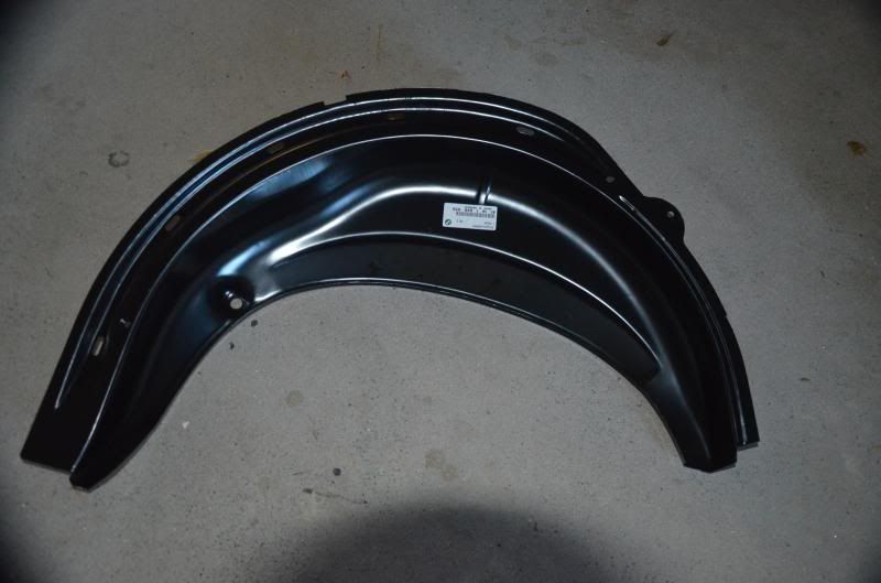

Lateron, somewhere next week, I will awnser this question extensively. For now, just look in my english 323i topic, to see how much work needs to be done when you want to replace them complete.
- Posts: 3133
Re: Rusty rear inner arches
uwbuurman did the job how it should, cut out the whole inner wheel arch and replaced it. He knows all about the E21 shell.
Such a repair is only possible when the car is dismantled completely. If your plan is only repair the worst rotten pieces and drive the vehicle for some more years, some patchwork is also possible

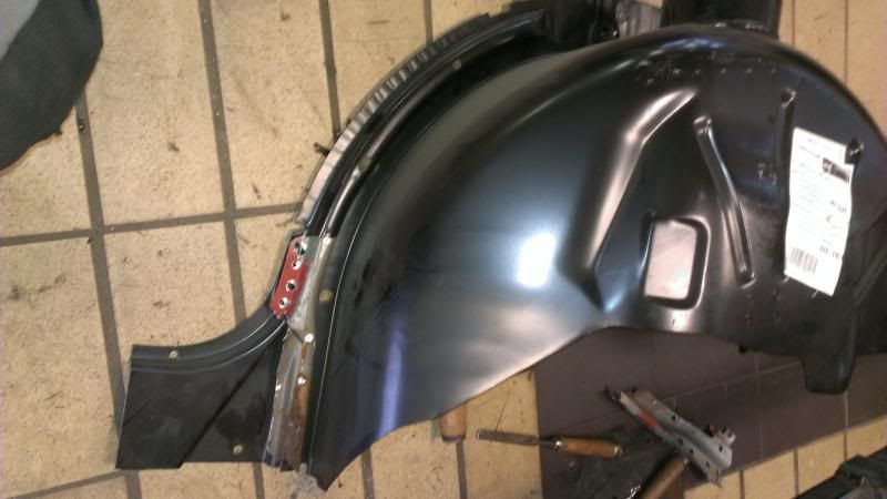

Indeed, what Rob did, is the best way to repair incase of patchwork. Nothing wrong with that.
The replace the inner arch complete, you do nog take the whole of the car apart, but a large part. You can not fit the rear inner arch without making a cut of some 2 inches in the bootfloor.

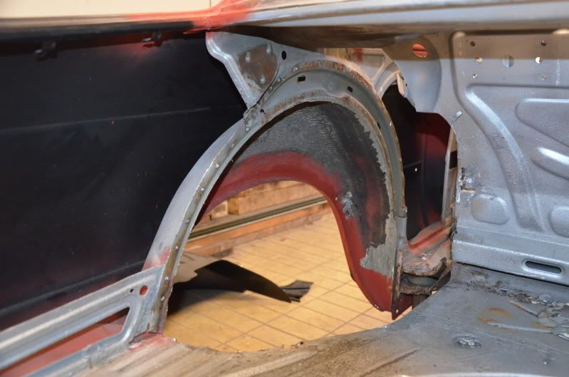

It is possible, if you keep the outer arch complete, you dont have to cut open the sidepanel, at the sill.
Look in my topic, after the sidepanels were replaced, i replaced a corner of the outer arch, because of the new side panels I did that from the other side.
The inner arch runs BETWEEN the inner and outer sill/bodypanel.
Exactly the part you want to cut of so you can put in the outer arch without cutting the side panel, that corner is always rotten...
The thing is, getting the outer arch out, will most definetly give problems at the wheelarch, where it is spotwelded also.
All in all it will be a crappy job, with lots of little repairs needed. It will be a hassle also to get the pipe that runs the airhose from the tank welded back, since that is welded on the outside of the wheeelarch, before the side panel goes on. It can be done, but Not very easy.
Inner arch, the square platen runs between inner and outer sill
The outer arch
To understand better what I mean, just look in my topic at around page 14.
