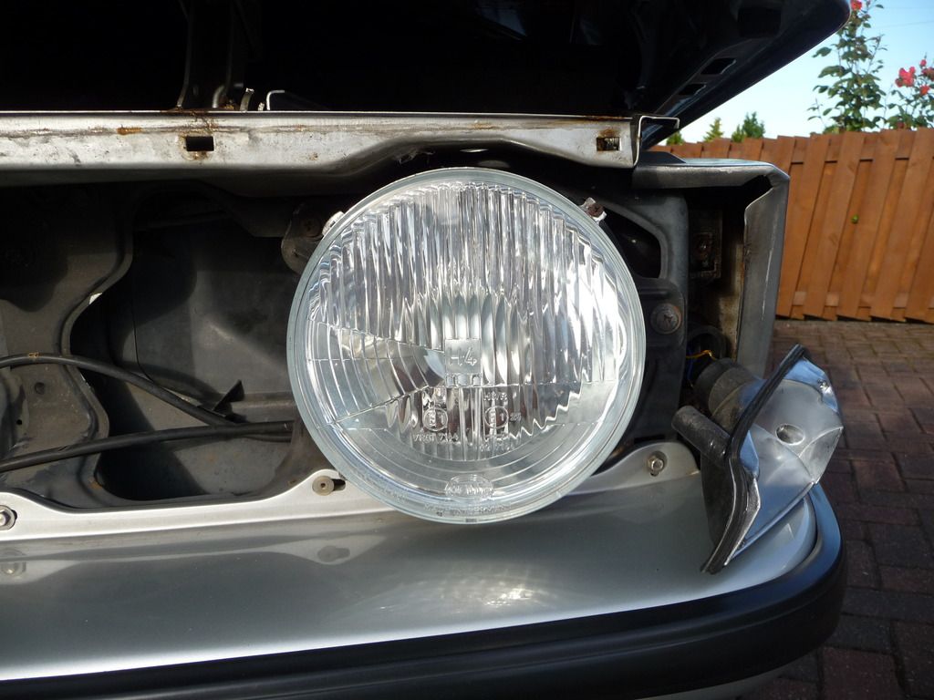

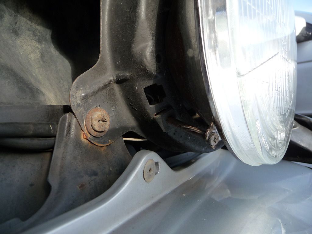

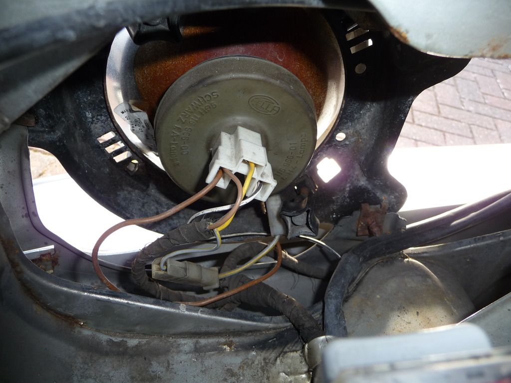

I adapted mk1 golf Hella headlights on my car, a much cheaper and more plentiful option, and they don't corrode like the Bosch originals.
I failed to take pics of the process, but it basically went as follows:
Remove adjuster threads from old lamps and clean up and fit to new lamps.
Mark and cut new mounting points in the original E21 mounting frame as the ones on the new lamps are in a slightly different place.
Fit lamps to mounting brackets and fit on the car.
Add extra wiring for the sidelight bulb which is seperate on the Hella lamps, and swap the plug on the main lamp wiring
Fitted, this is the end result:
They work a treat, and look so much fresher than the manky old ones.
Andy

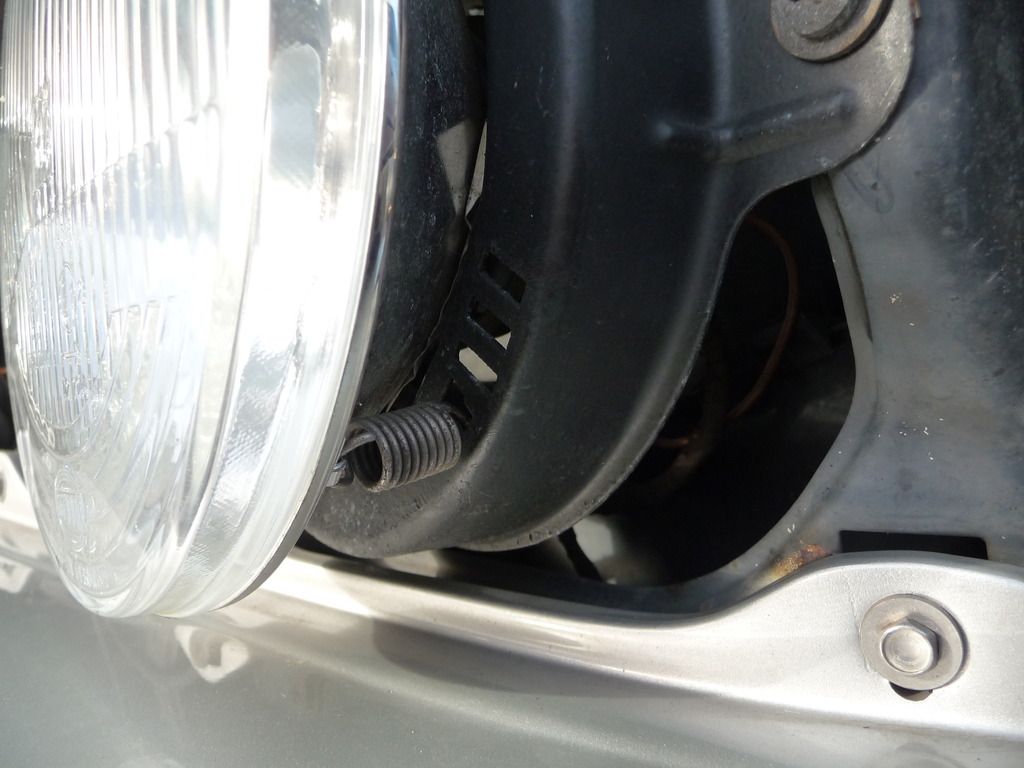

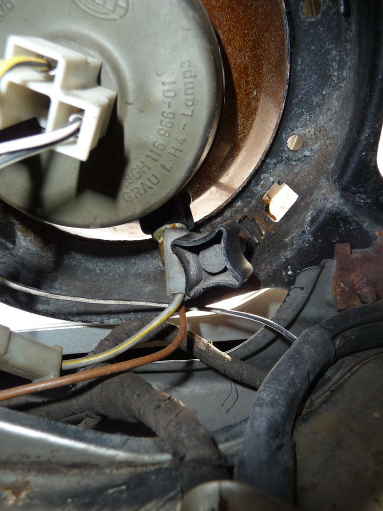

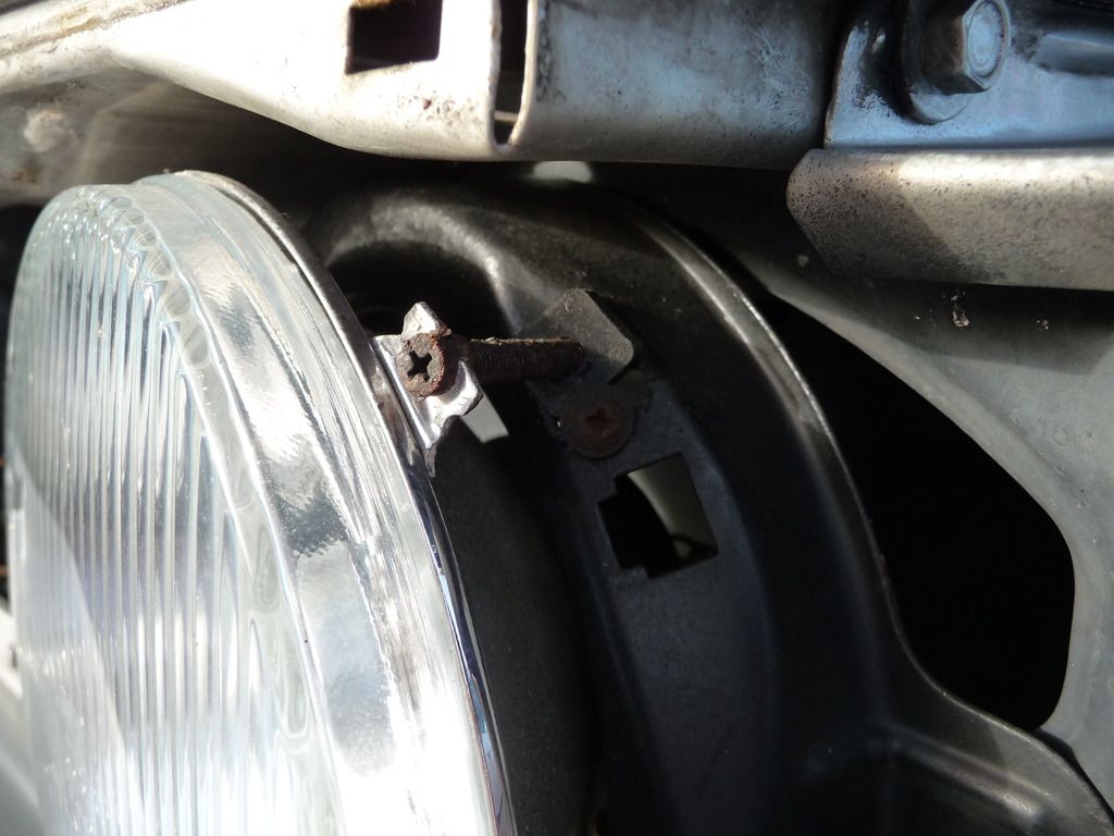

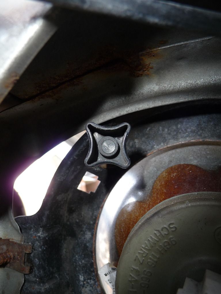

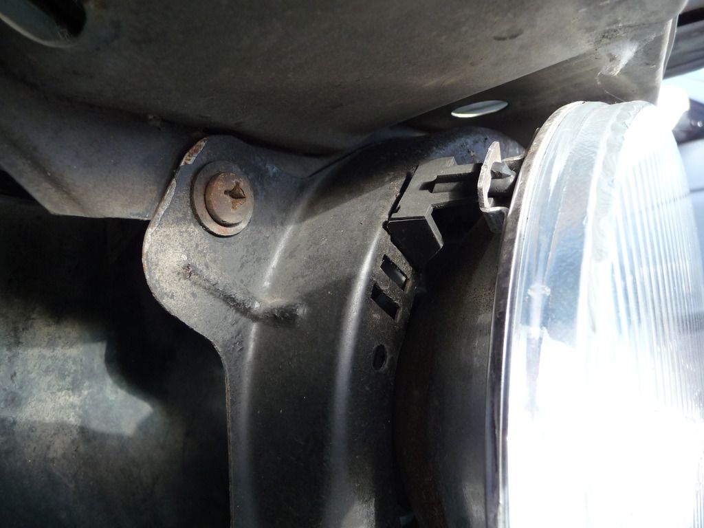

From memory, (and I'll have my grille off and back it up with pics in an hour or so) I got the mk1 Golf headlamp unit, and it's mounting ring and adjusters, then modified the E21 mounting rings to accept the mk1 golf adjusters as the position is a little different. It's a bit of a mix and match with regard to adjusters and springs, but it all works.
Andy

polov8
Posts: 522
Location: Dronfield
Re: LHD to RHD single headlights.
Post by polov8 »
Ok, here's some pics, You'll need to reposition some of the adjusters and springs, but I can't quite remember which ones. It'll probably become clear when you put them side by side. For the adjusters, this involves making specially shaped holes to allow the plastic fittings to lock into the metal frame.
Hope these are helpful!
Andy
