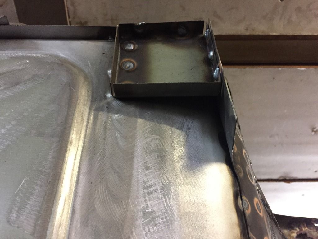

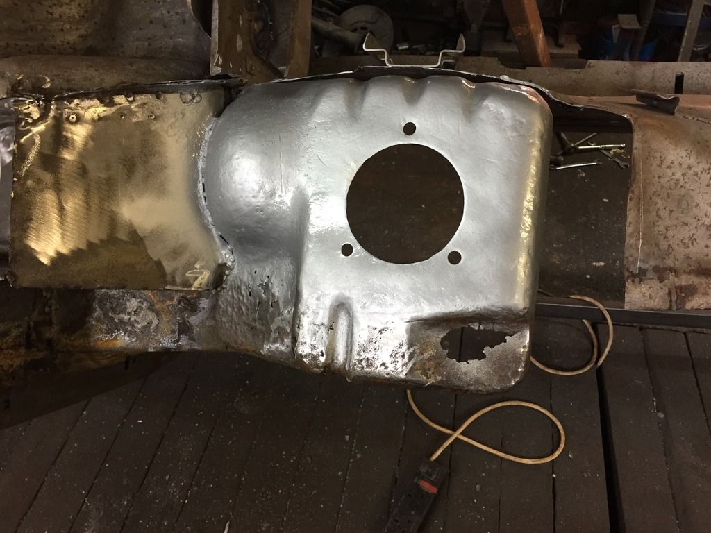

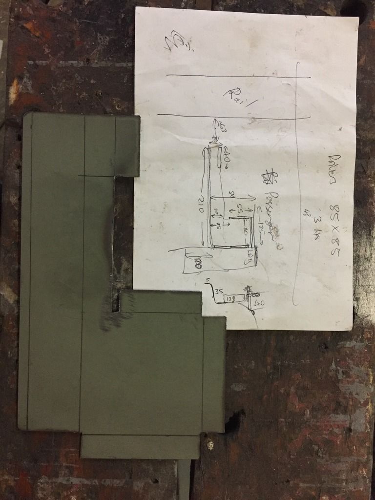

The non jacking pads for shell painting, which include the fuel pipe protection guard:

Great!!! I cut out those big round holes to fit the original caps in the center of the floorboards. This looks ok, but original is better looking ;-) car won't see any snow or rain again, so it shouldn't be a problem.
What tool do you use to bend that sheetmetal?

uwbuurman wrote:Great!!! I cut out those big round holes to fit the original caps in the center of the floorboards. This looks ok, but original is better looking ;-) car won't see any snow or rain again, so it shouldn't be a problem.
Yes we will be cutting out the holes to fit the floor plugs, the holes are needed for draining during dip-coating.
As for tools, mostly normal hand tools, vices, lengths of bar stock (round / box section etc) etc.

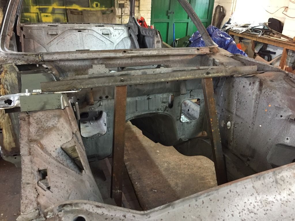

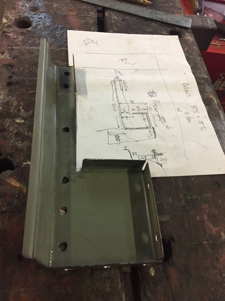

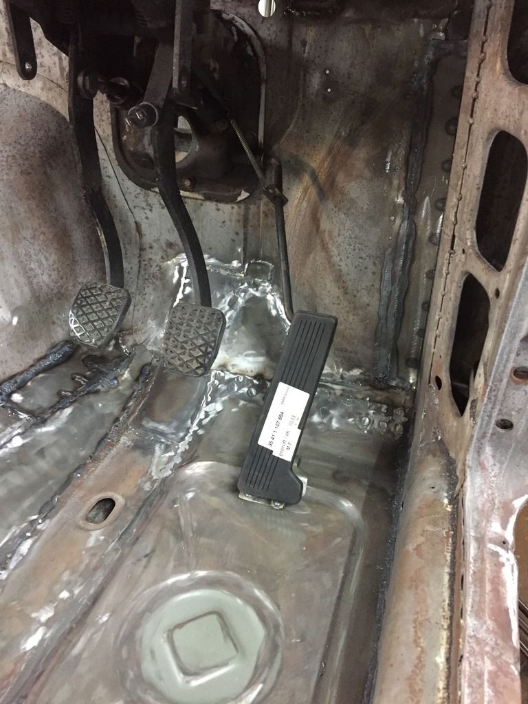

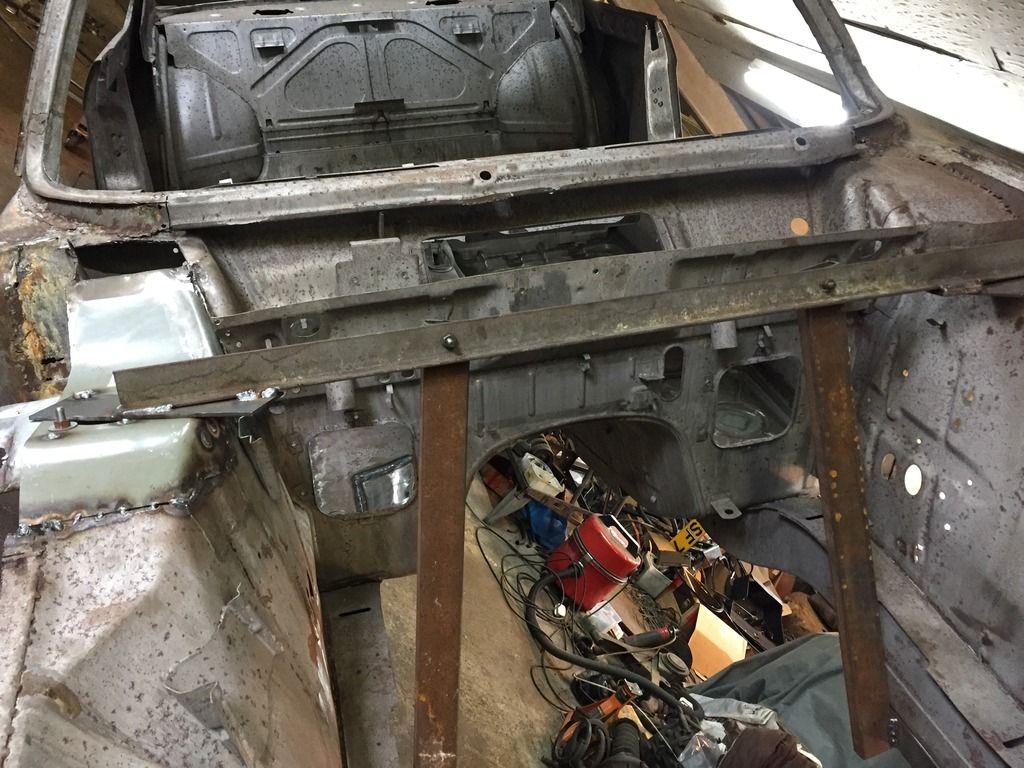

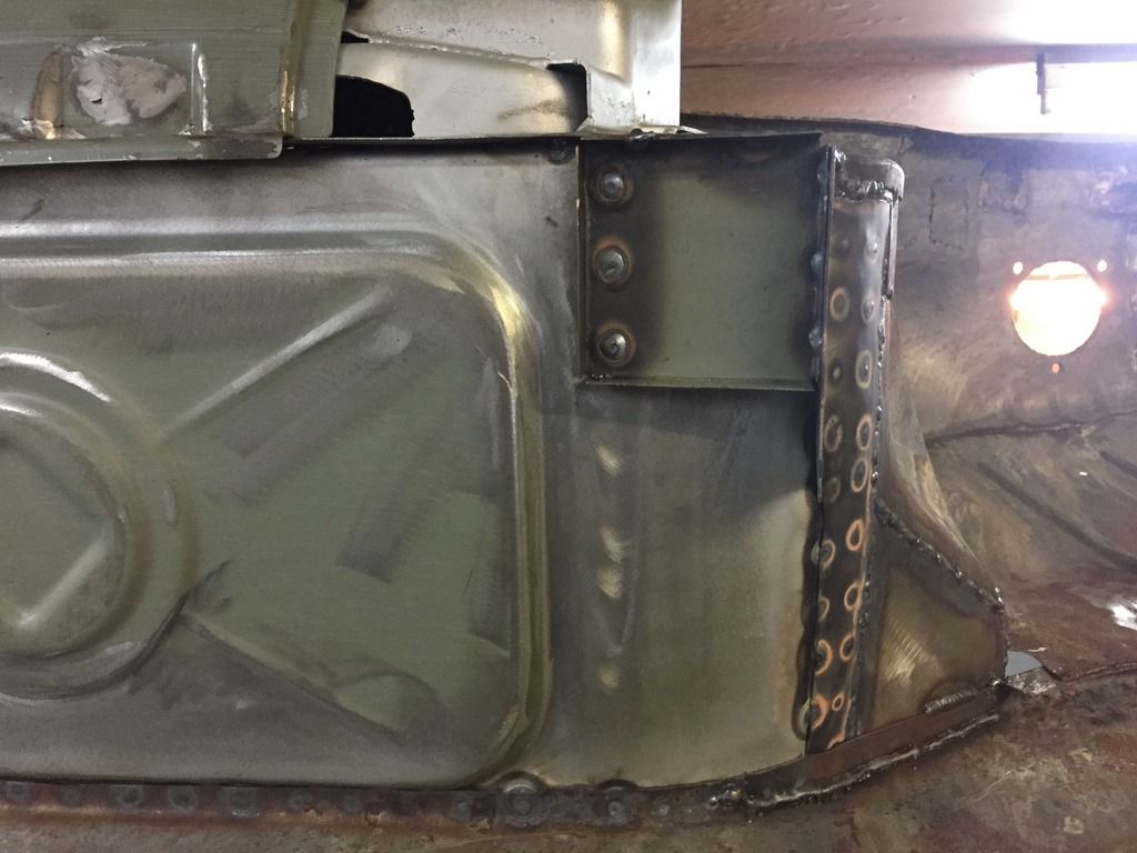

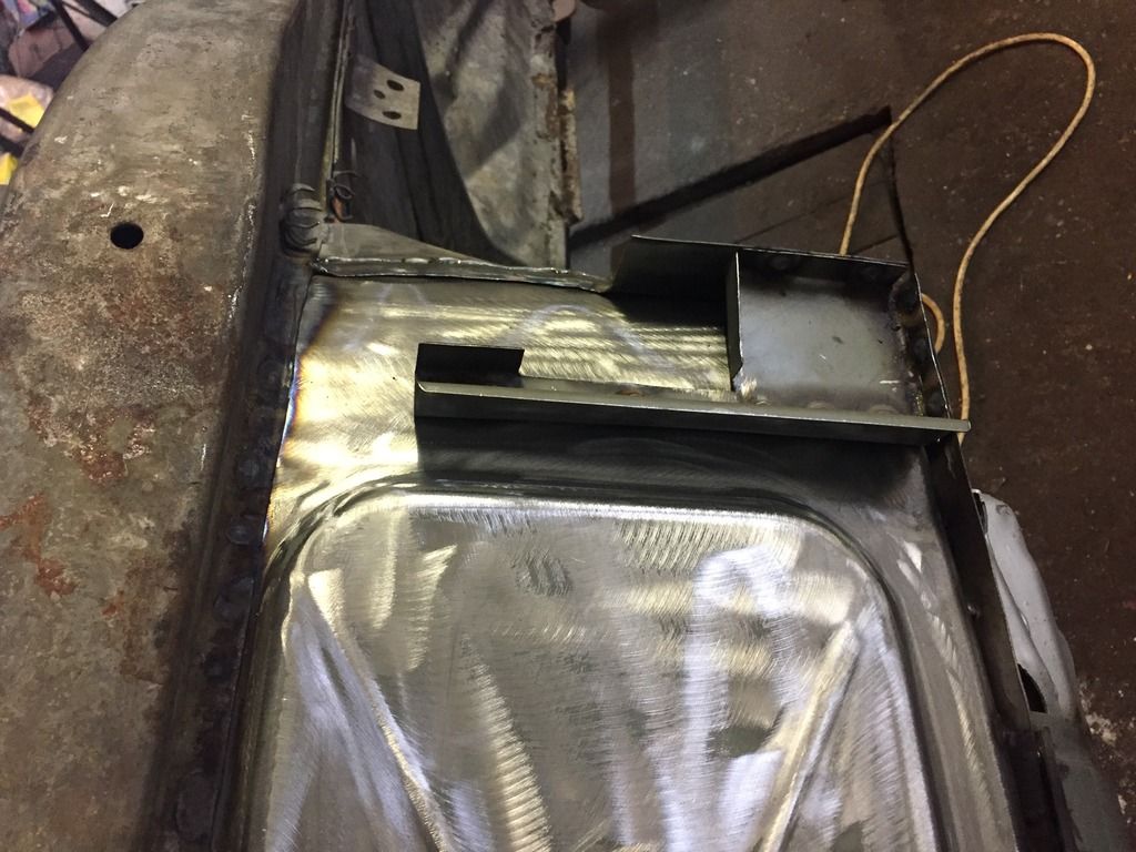

Trial fitted the pedal box to get the throttle pedal position and welded the mount in:

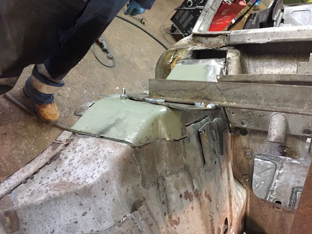

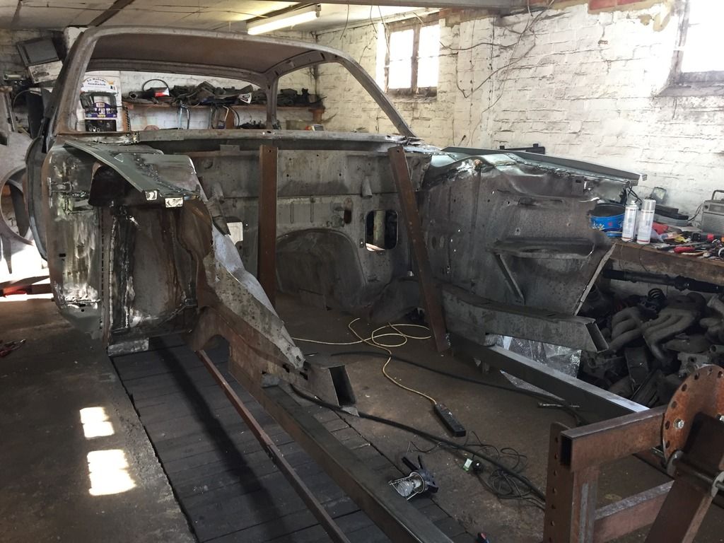

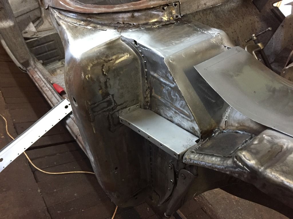

Started work on the strut tops, first we made a brace to retain the location:

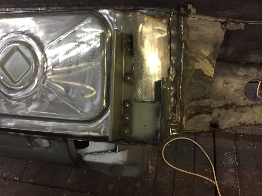

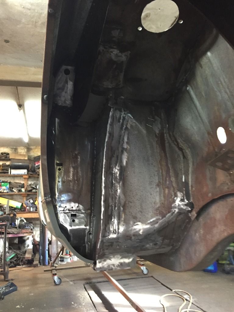

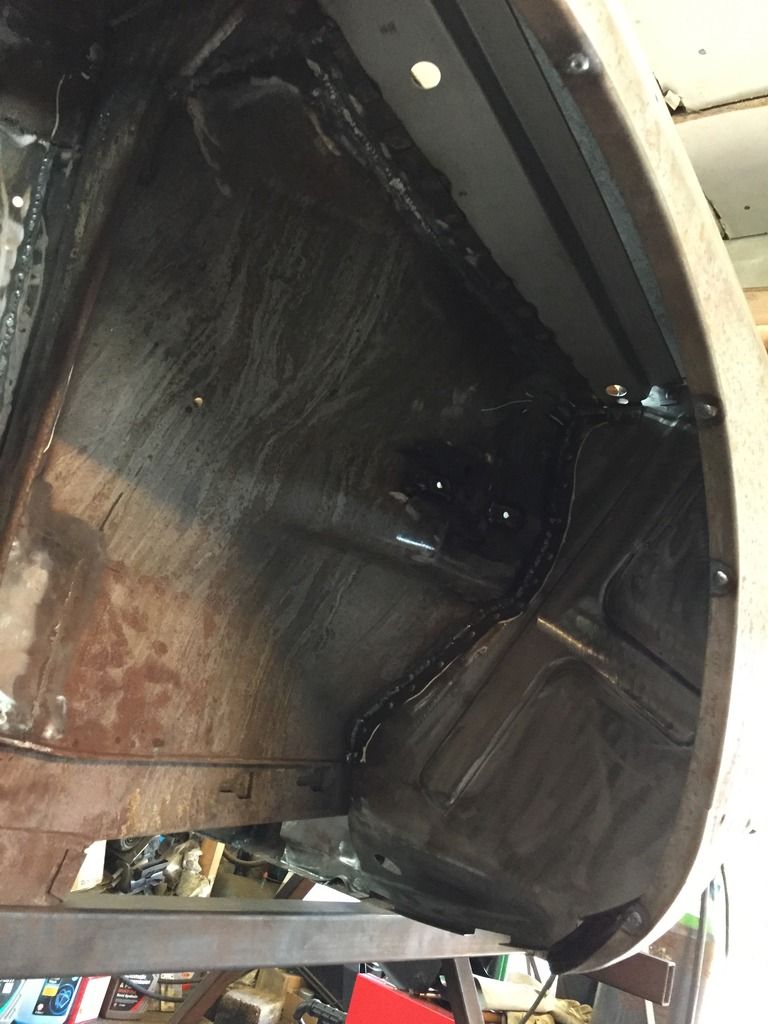

The cracked on with removing the bad metal to see what was needed, I was a bit slack with taking photos so things may jump about a bit:

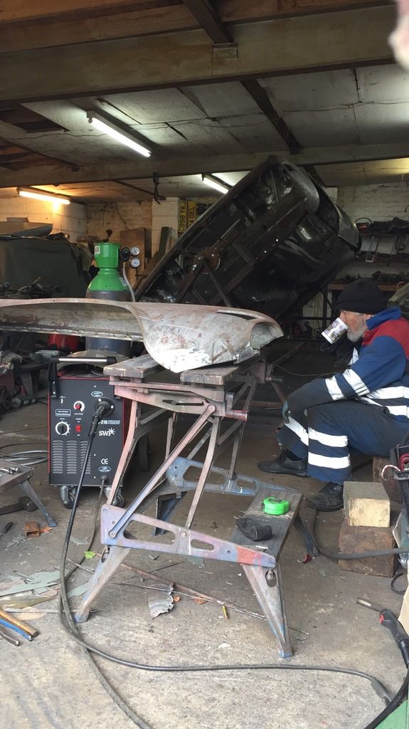

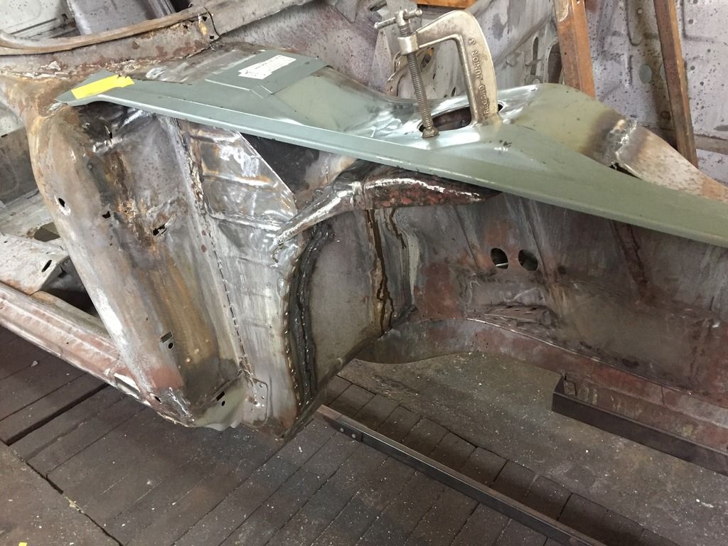

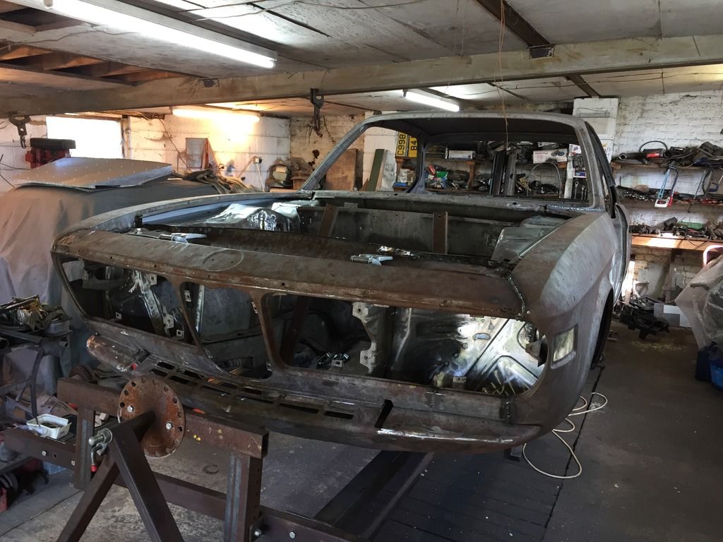

After that was all back together we removed the whole front panel to replace the splash guards and do lots more repairs on the front panel:

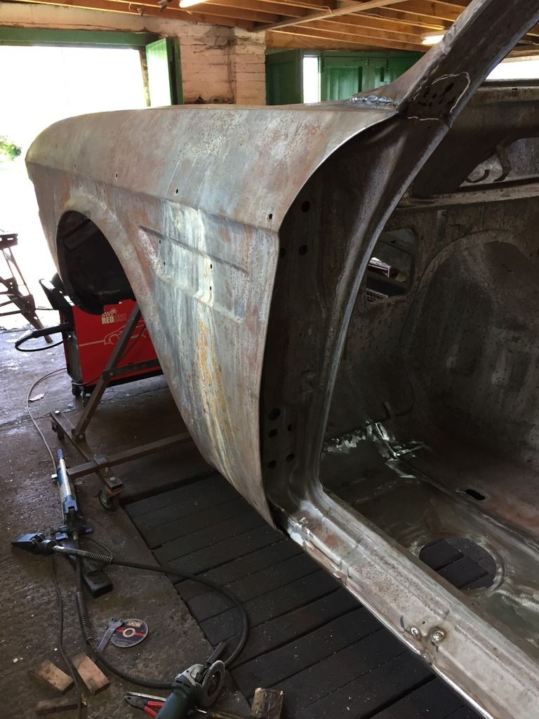

Well, just realised we missed taking pics of quite a bit (was busy with the E21 - must update that as well).

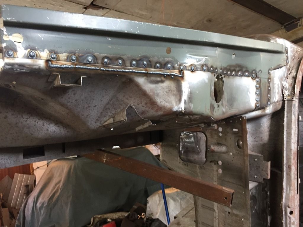

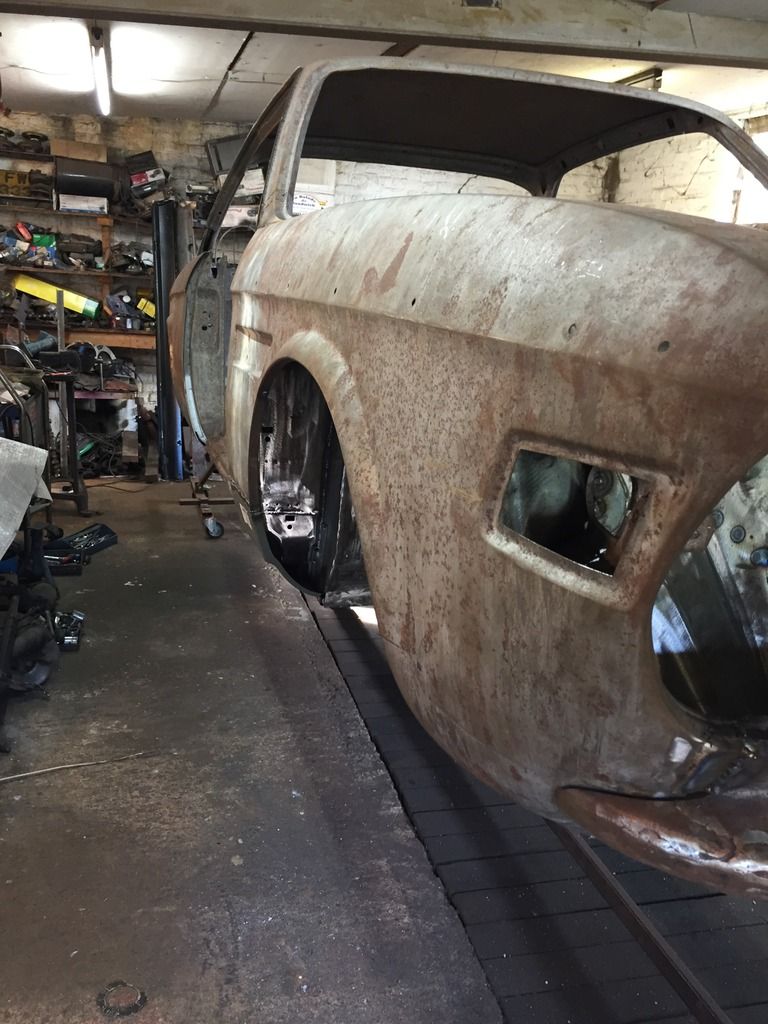

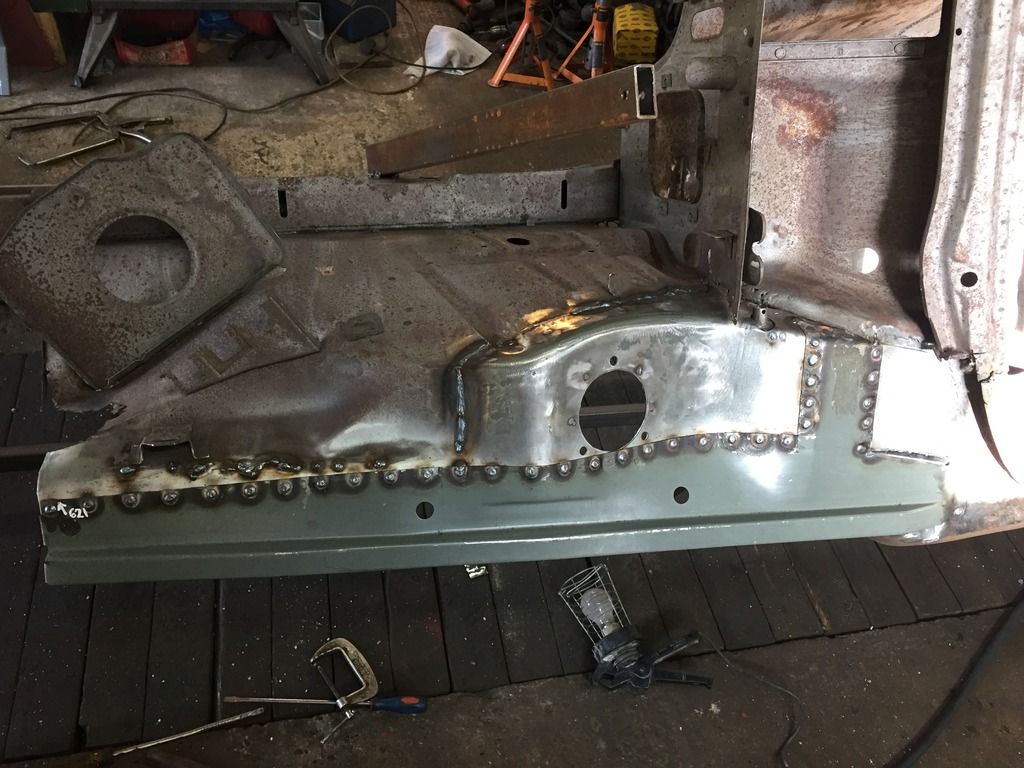

The front panel went back on and we repaired the front wings before getting them back on.
First pic was a coffee break before the second wing went on:

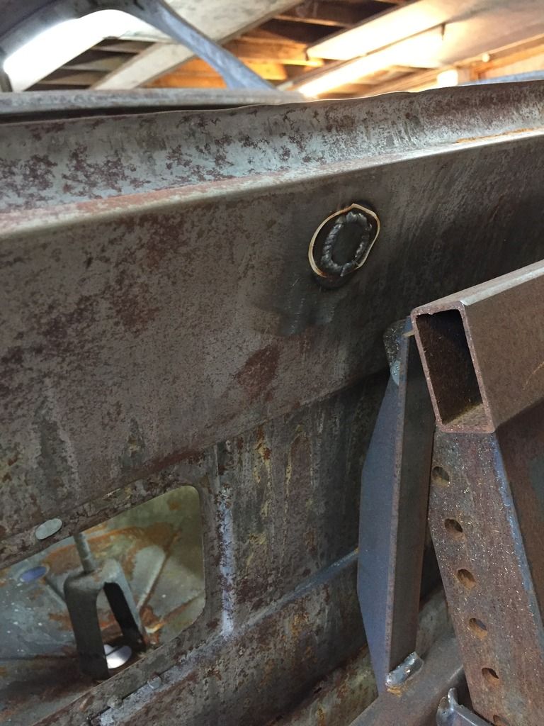

We also went round the rest of the shell fixing bits and bobs like this extra hole in the rear panel:
