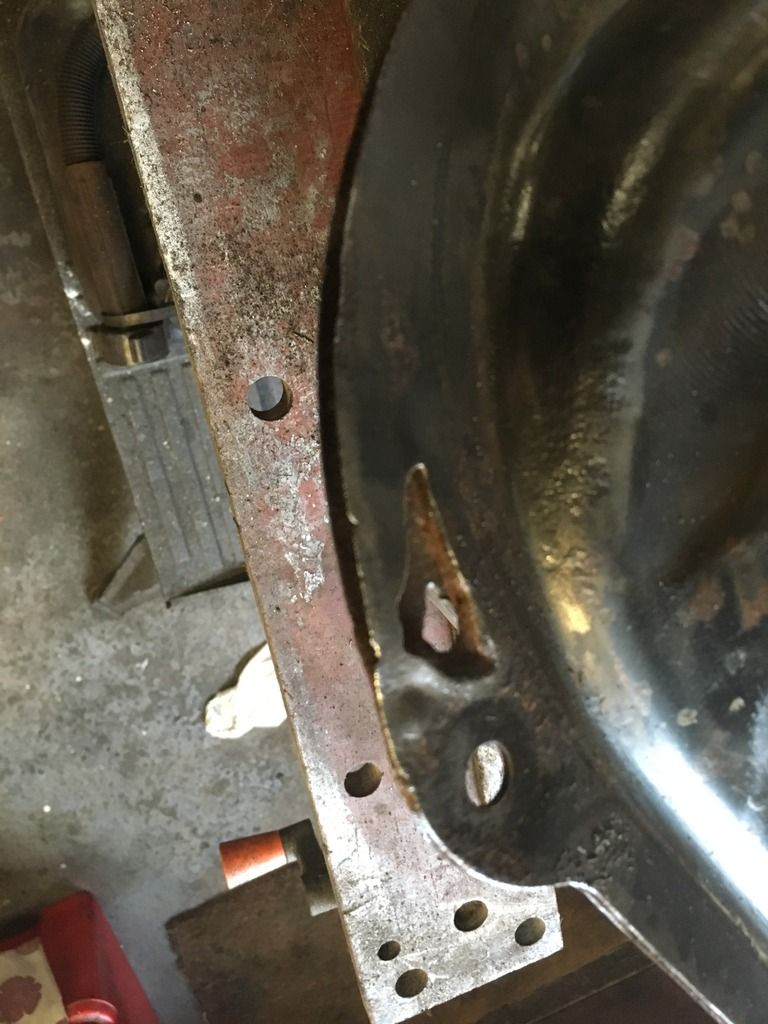

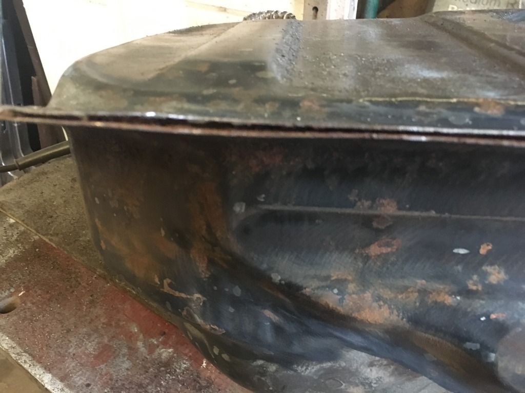

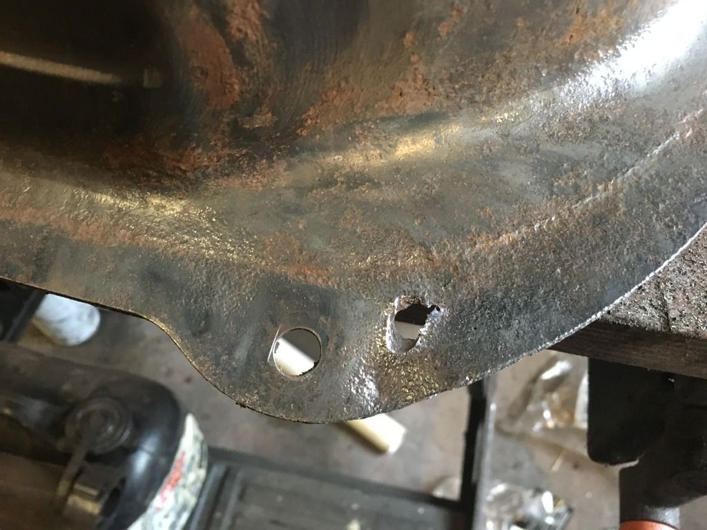

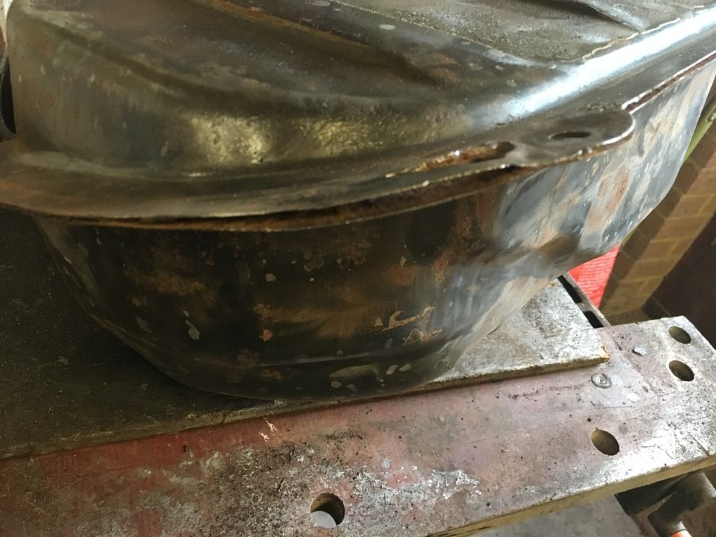

It's not so much the inside that I'm concerned about, that all looks good. The seems along the front are all rusted, holed in a couple of places, so they need welding first and I'm not great at welding! The quote to have them done professionally is £660, or I can have new ones for just over £1000 from the dealer.

Is there a leak? The seems around have a reasonable flange. In that flange it is common to have rust and holes, but the weld is still ok. Please place some pictures here, so we can help judging.
These are mine.
These are mine.
Re: Fuel Tanks, What to do Refurb or Replace?
OK, here are some pics
- Posts: 19241
Thats quite the same as mine. Not leaking. Two options, just carefully open up the seem and have it sandblasted an powdercoated, afterwards fill the seems with some Dinitrol. Or have the holes welded, but stay away from the original weld, that holds the two halves together. But 650 is a laugh. Should be max 50 pound.
