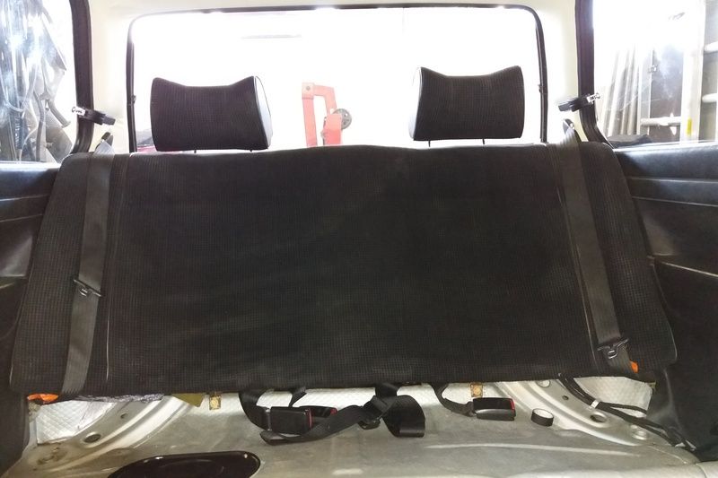

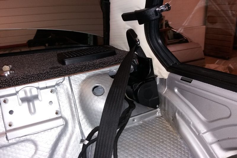

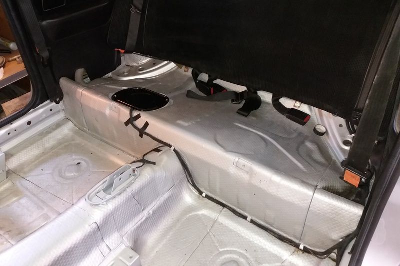

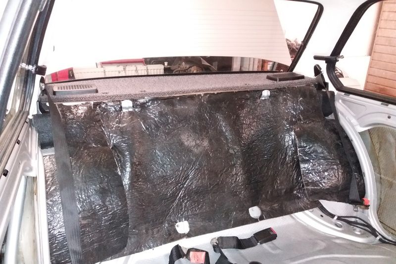

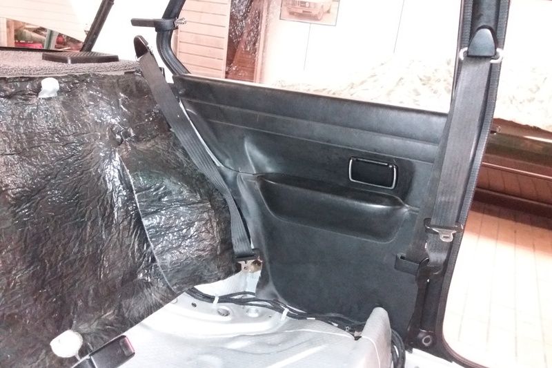

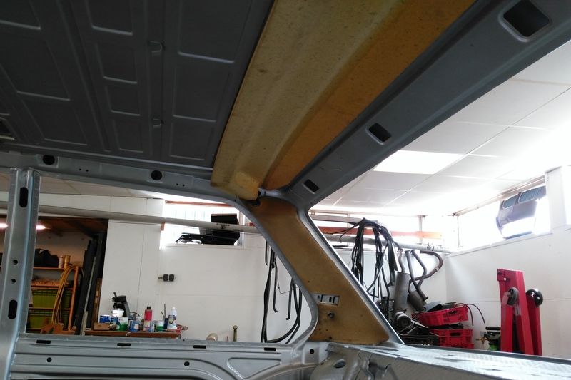

I acn hardly imagine that any post facelift E21 left the factory without rear seat belts! I'd start by removing the rear seat, you should either find parts of the seat belts or connection points. Some pics from Koos 'uwbuurman' restoration so you can see how things are supposed to be fitted.

Below the top, or the back part, are two bolts. Get those out. Then slide the whole thing like 1.5 inch upwards. As you see on the first photo Jeroen posted there are hooks that hold the backrest.

Good news - I was able to take the seat out and found:
1) holes drilled for the upper seat belt assembly just below the parcel shelf (from picture 1 above)
2) holes drilled for the lower seat belt assembly (last picture above)
On the 'c' pillar itself (the part visible inside the car in white in picture 1) there doesn't seem to be any holes. Does anyone know how to attach this part to the car?

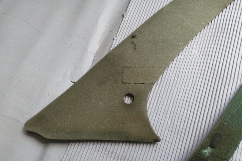

- Posts: 30176
Re: e21 rear seat belts
Pretty sure the hole is there behind the vinyl and foam, you should be able to feel it.
Thanks. Yes I just had a poke around and I could feel the hole in the foam leading to a thread. Looks like we are all good !
