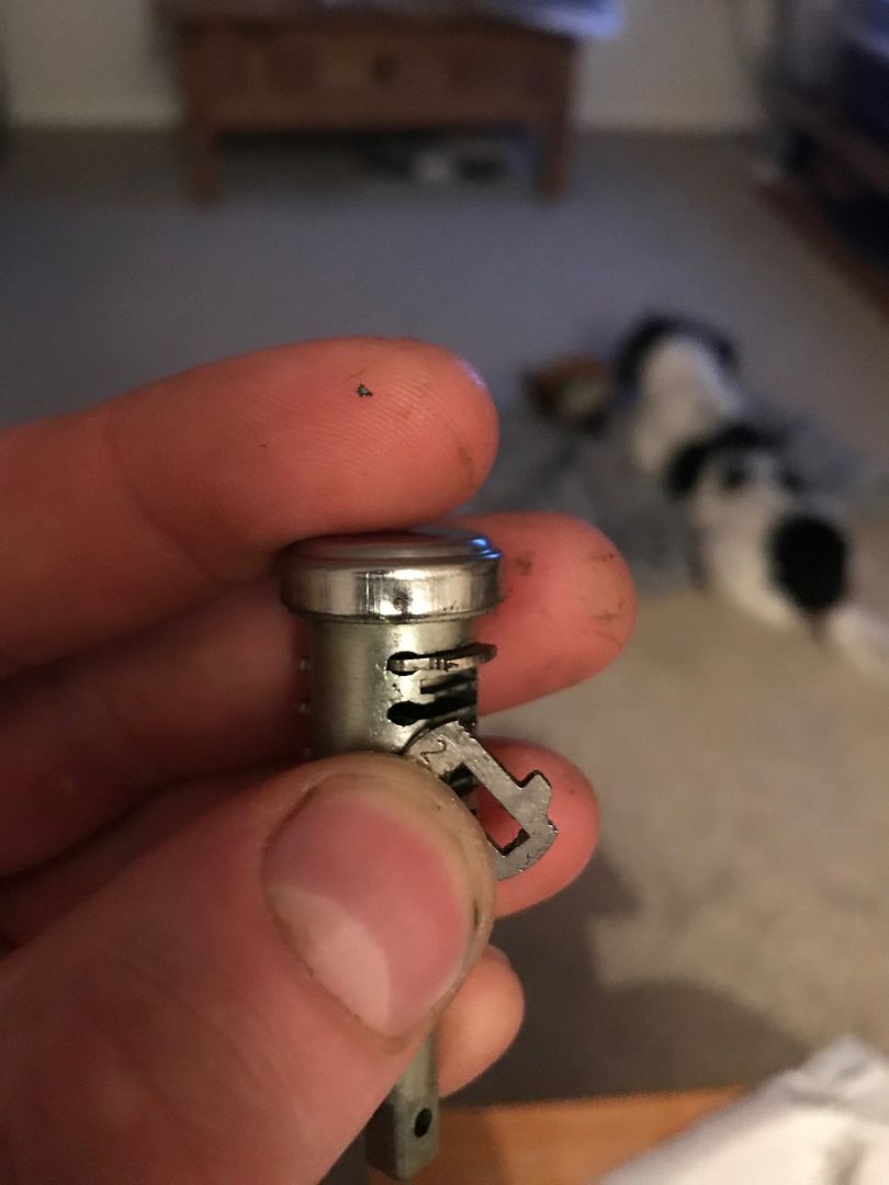

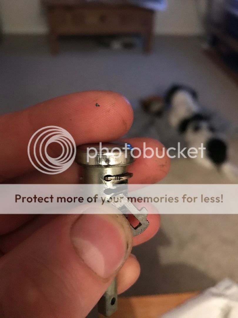

Hi,
Just curious on this subject, I used to work for BMW Motorrad and would code barrels using a pre-cut key for accessories such as panniers. The key would have a code that would correspond with the numbers on the pins supplied in a pack.
I took apart my barrel as I need a new key but want to maintain the locks. Each pin, 8 in total, have a number stamped on them which denotes a pin height or key cut depth, I'm hoping a locksmith will know how to set this up on a machine and cut me a new OEM key.
I'm sure some people know this but it's an FYI to people who read this post!
