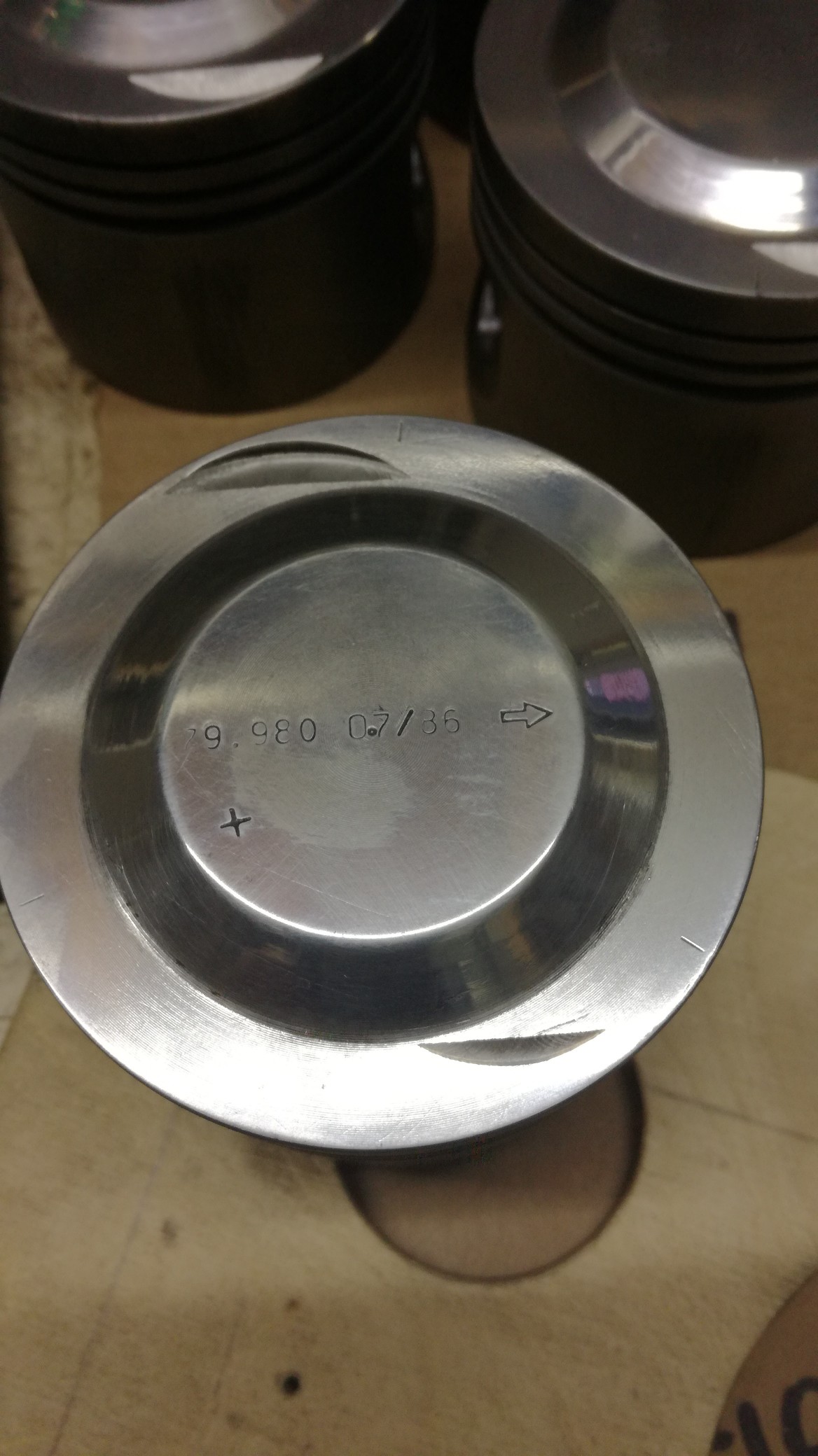

Yep clearance between exhaust valves and pistons in a M20B20 is verry minimal, i've seen several pistons with hit damage from exhaust valves.
If the head is skimmed, clearence gets a bigger problem.
Thats why i've made exhaust valve pockets in my pistons for a new to build engine.

No i don't, when the valve guide's were worn too, the bent valves might still have done their job, because they had some more play, they sealed anyway.bealo wrote: Fri Jan 03, 2020 7:37 pm So you don’t find it odd that all 6 appear to be bent?
I’ve had the head skimmed to I’ll have to closely at valve/piston clearances
M20B20 engines have the tightest piston valve clearence to get a proper compression rate, because of the short stroke (66mm) .
I've got a set of high compression pistons (M20B20 LJET), and they all had minor hitting damage from the exhaust valves, don't know the history of that motor they came out:
and thats why i reworked those pistons by adding a exhaust valve pocket and made the inlet pocket a little deeper.
