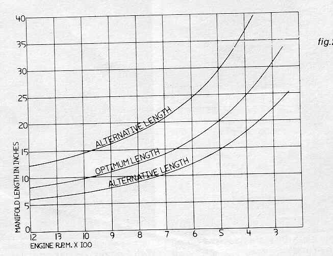

The cylinders on a 2.3 are smaller than on an M10 1.8 or 2.0. I would say something like a choke of 36 or 38mm. Certainly not 'as big as possible'.
Another thing to consider is the length of the runners. Cylinders with one inlet valve with 'limited' rpm need quite some length, a lot more than you see on average.
When you tune this right, quite a lot will happen with torque. A 20" runner is unpractical, but 15", or 40cm, can be approached.
