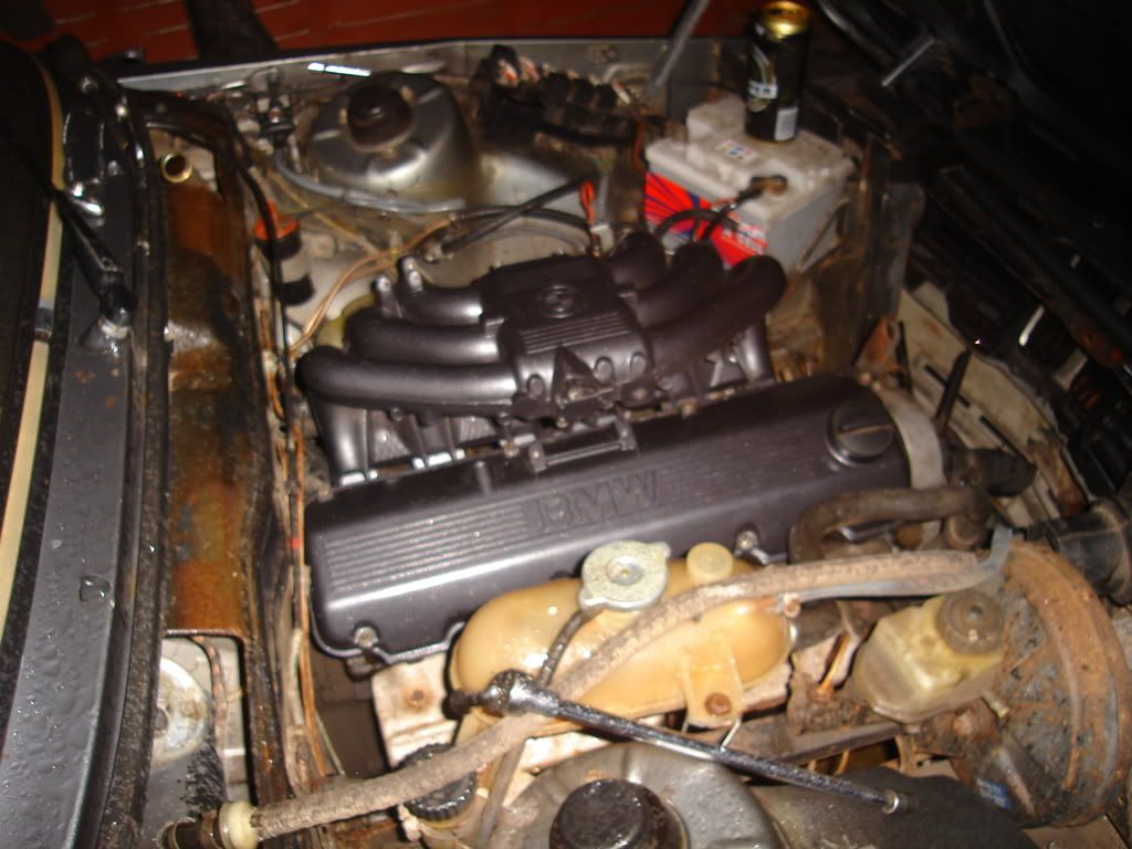

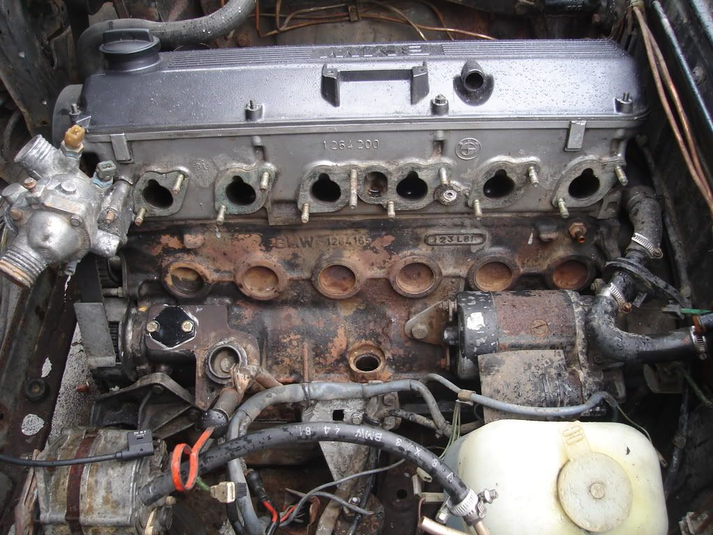

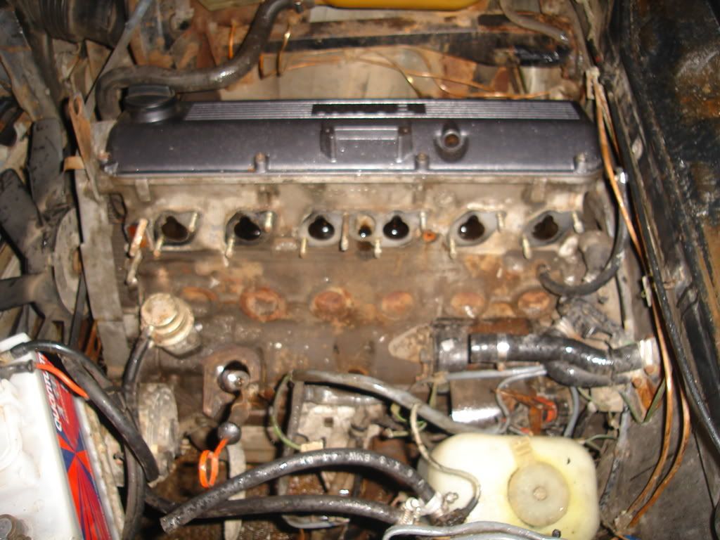

was finally making a start on the motronic conversion yesterday inbetween the heavy rain showers.
stripped the carb off the manifold and threw it down the garden as far as i could. (does anyone want to buy it btw! lol!)

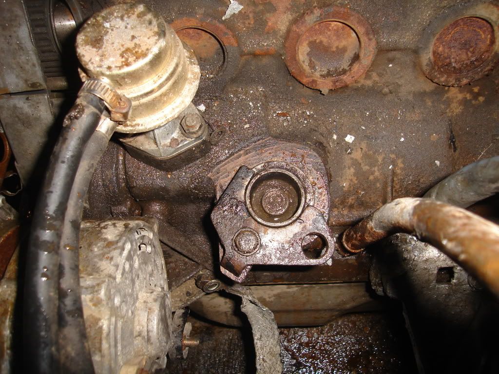

then the manifold came off, dizzy off and e30 blanking plate in. im guna make a blanking plate for the fuel pump too.

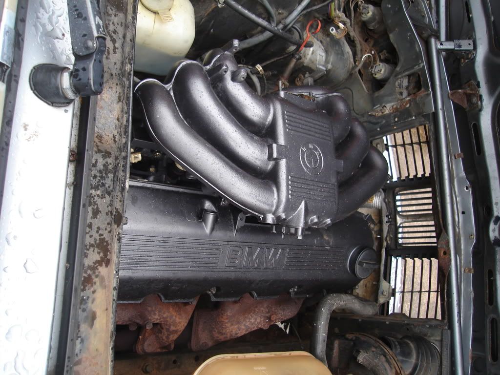

put the e30 cam cover on, then tried the manifold on. looks good.
need to fit the e30 cam pulley.

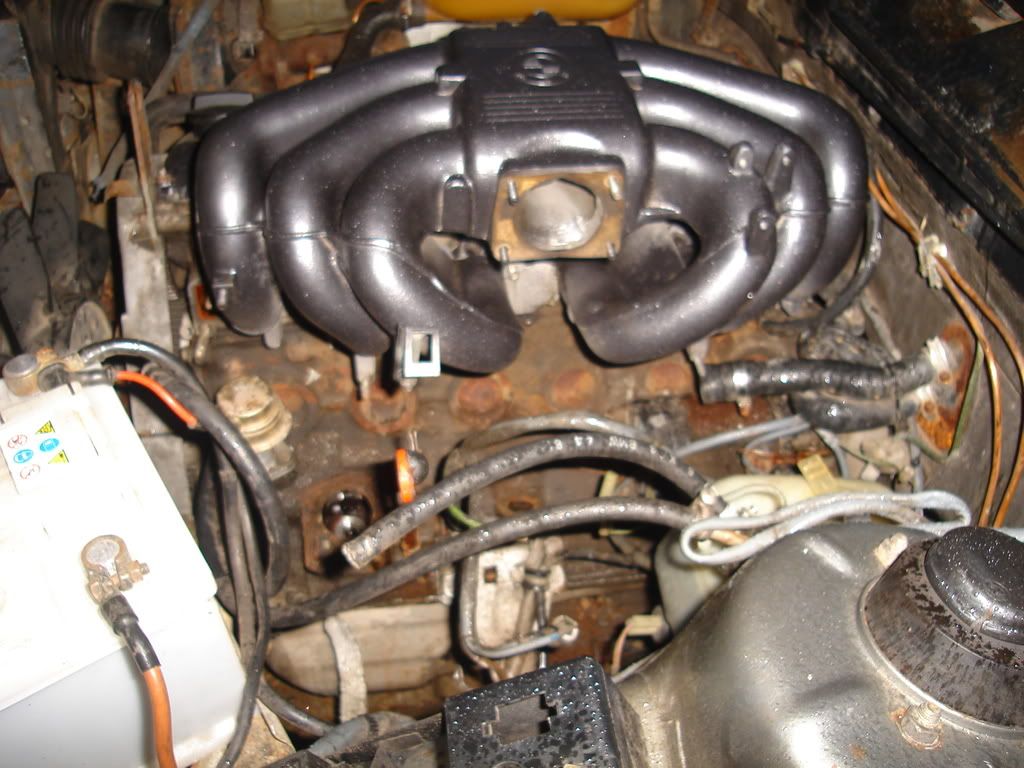

and looks like ill have to evict the battery and banish it to the boot!
collecting all the other bits loom, ecu etc on saturday.......
pics so far.......
remind me to put that earth lead back on please. i did do the last bit of this in the dark!

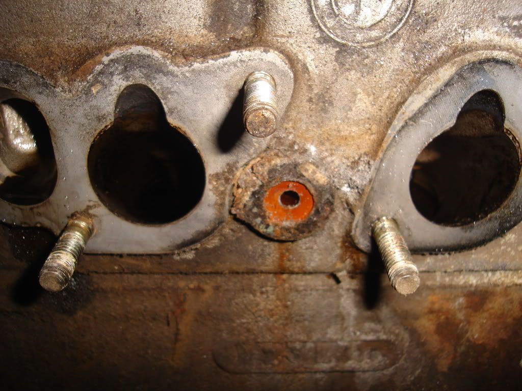

oh one question!! what do i do about this little hole?? tap a thread in it and thread lock a bolt in it?? :?

For gods sakes murran, you could have given the block a little clean up and maybe a little paint!!!
good luck on the conversion!!!, you will enjoy the performance!!! and the battery definetly has to go into the boot cos the airflow meter will be inits place!!! use the 173 ecu and software 1.3 and if you need a chip i know someone who sells a hi-performance chip!! that would get your bollox frying :lol: :lol: :lol: :lol:

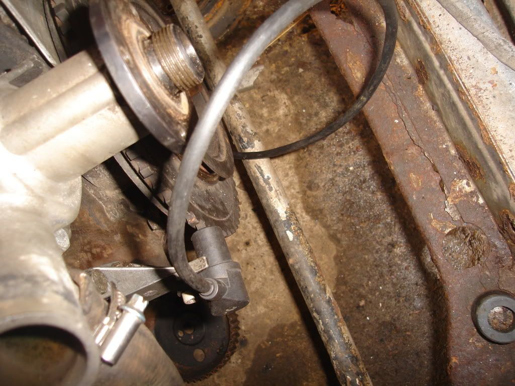

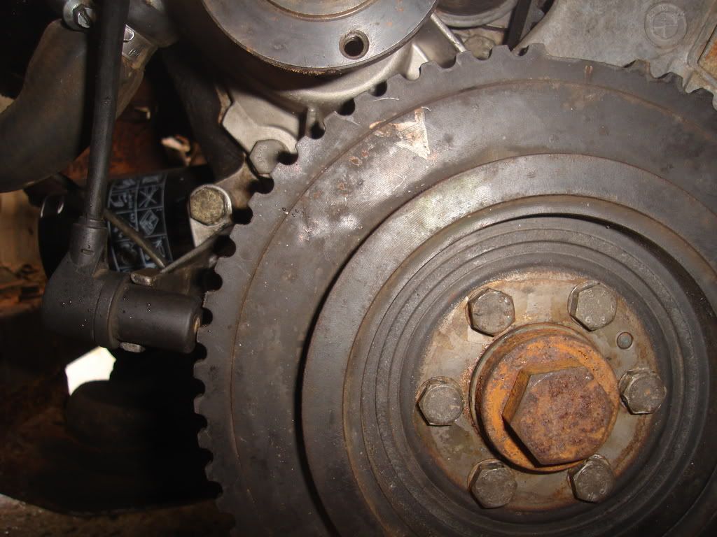

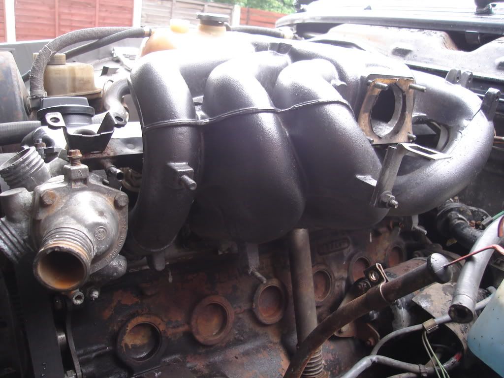

more pics.....
cleaned and degreased (thanks alpina!)
manifold and cooling housing bolted on breather tube in.

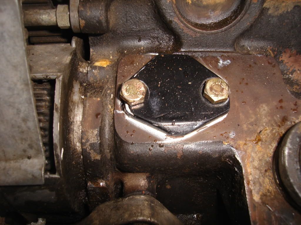

little plate ive made to cover the fuel pump hole. took the studs out and put bolts in insted.
crank sensor bolted on ready, e30 front pulley on too

Yeah murran, much much better mate!! what ill do is get a can of black spray and give it a quick spray over just to hide surface rust, otherwise its better than before!! much cleaner!!!
