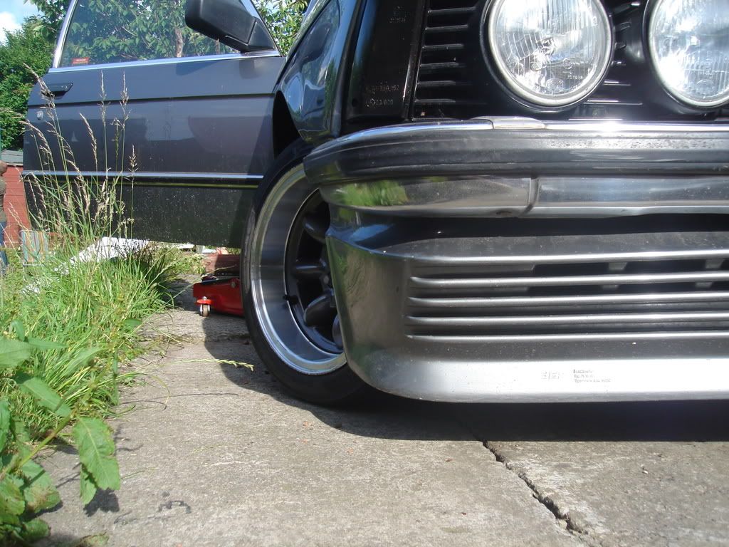

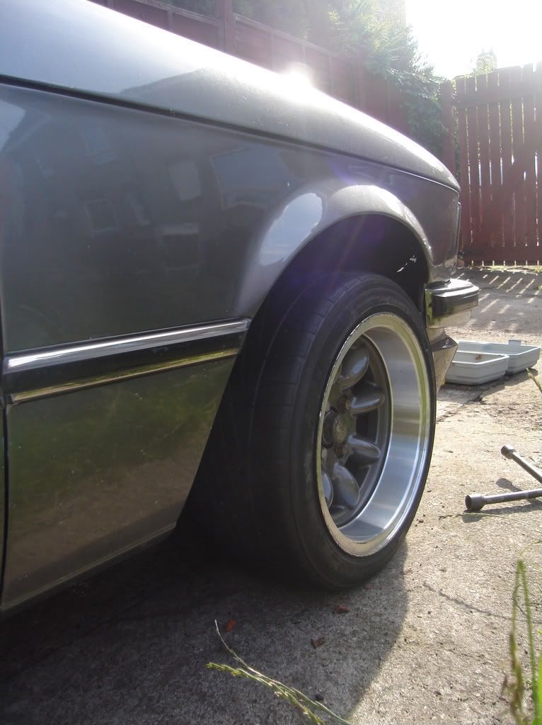

the one i tryed on the front of mine had a 175 50 13 on it and it didnt seem to catch. tho if i ever buy some ill be getting 185 60 13.
next problem is fitment mini size is 4x101.8 not 4x100 but its acceptable with some "wobble" bolts. ford fitment ones ie 4x108 is a no no.
if the wheels catch then bend the bit of the car out of the way so it doesnt. simple.
