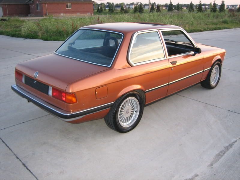

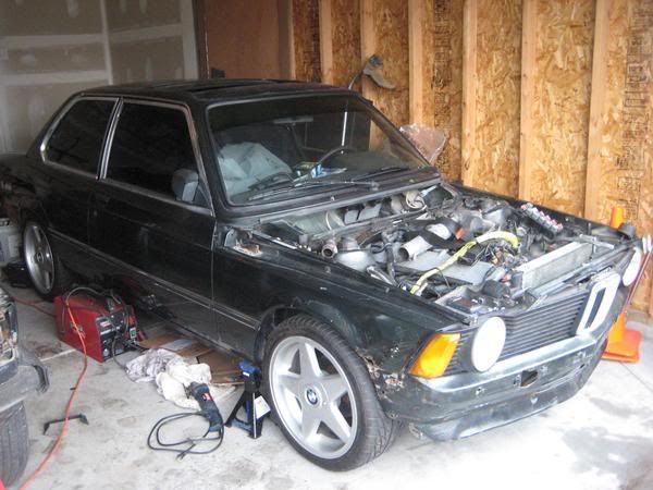

so like some of you guys know. i have couple of e21 project cars. i got the turbo car done and it is running very strong.. it is overheating. it might be a blown head gasket but not a big deal. i will get it done soon.
i have tons of money put in this car. today i am finishing the exaust on it and painting the inside same as the outside. i emailed jeron for the color code so i can buy the paint..
anyway. here is some pictures of the car,
singal headlights
mono wiper
17 inch wheels
bilstein shocks and lowering springs
3,91 LSD.
745i euro turbo motor 3.2/3.5
265/ 5 speed manual trans out of a 735i
dash out of nascar and more and more..
and in the end some pictures of my other e21

car i am assuming is putting at least 350hp. now it is overheating so i am taking the engine apart and i am changing the head gasket.. and it might sound stupid but i am trying to add a supercharge on it .. so it will be turbocharged and supercharged.. not sure if that engine will hold all the power.. but i came up with the idea today and i was talking to a friend of mine have a 3.8 ford thumderbored supercharge ..
i want to see how far i can go with this project..

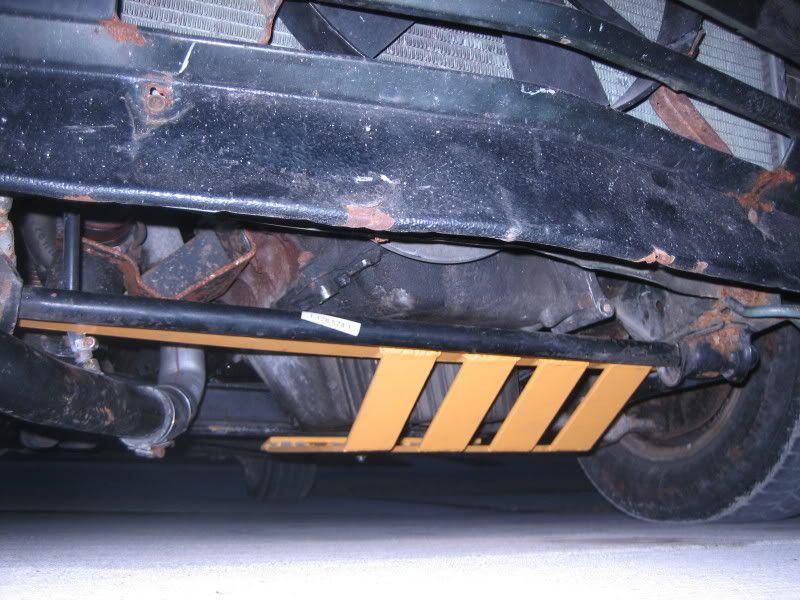

i did my own oil pan cover also.. it looks awsome on that car and i did mono wiper too..

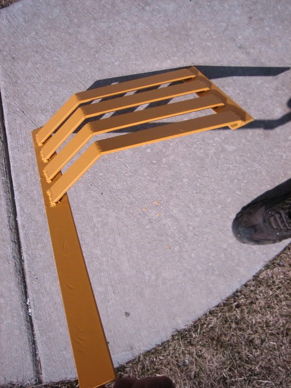

I was just joking with you and the handbrake!!! that oilpan/sump cover, do you have any close up pictures??? looks very good, can you give more information on that??? i wouldnt mind making one like that!!!! with all those bumps around london its rediculous....

that oil pan i did it myself.. just take mesurment and do it.. here is one more picture.. it is easier to see how it is done in this picture..
on the front it will hook to the sway bar bolt and in the rear there is a hole in the side of the subframe. so i just put a bolt there from the inside and that was it.. easy to make just take maybe 2 hours..

cool sump guard!
i was thinking of knocking one up but using the front anti roll bar as the forward mounts using another pair of antiroll bar mounts and turning them upside down. then bolting to the subframe at the back edge.....
atm mines too low to squeeze a guard inbetween the engine and the floor without it catching the floor all the time. needs lifting up a touch first.
