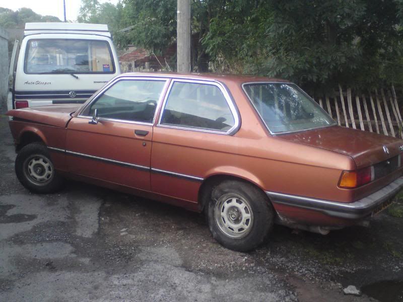

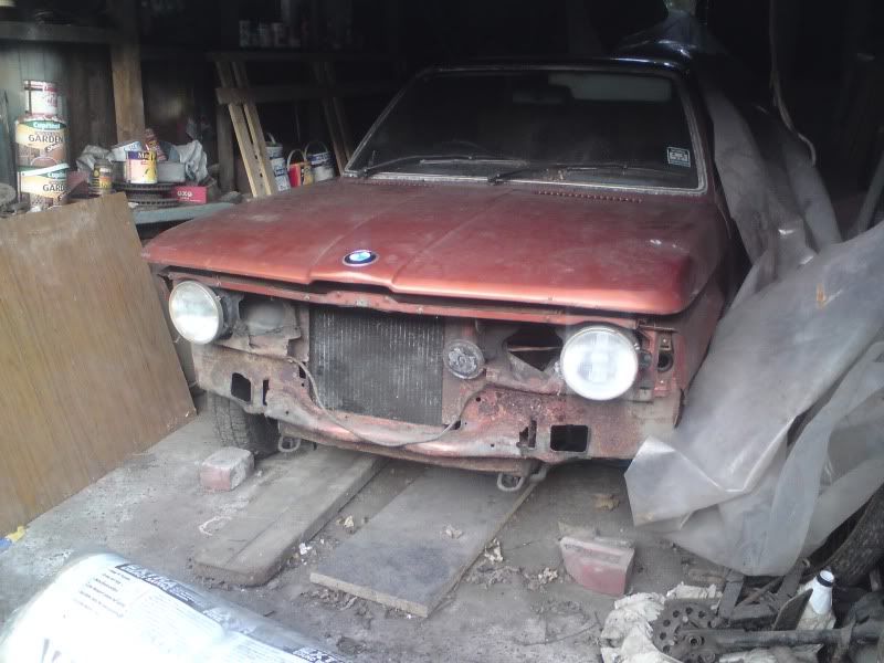

This is where I found it. Stored away in a garage for around 12 years.
I had to give it a tug out of its hiding hole, but this was the first time it had seen light for a while!!

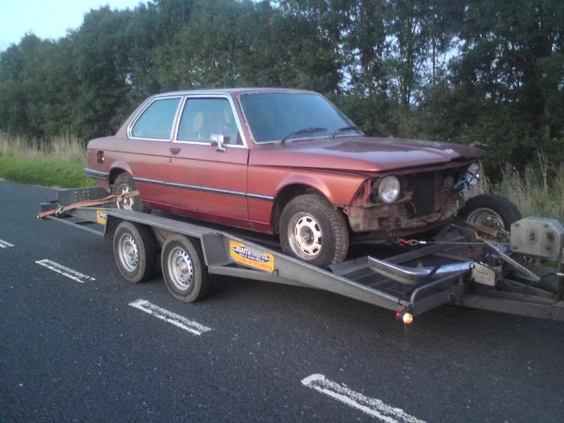

The trailer home.

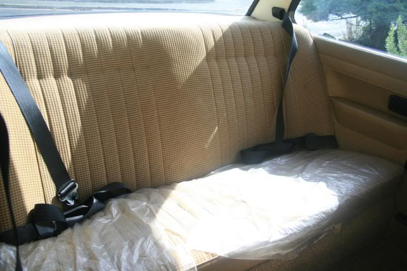

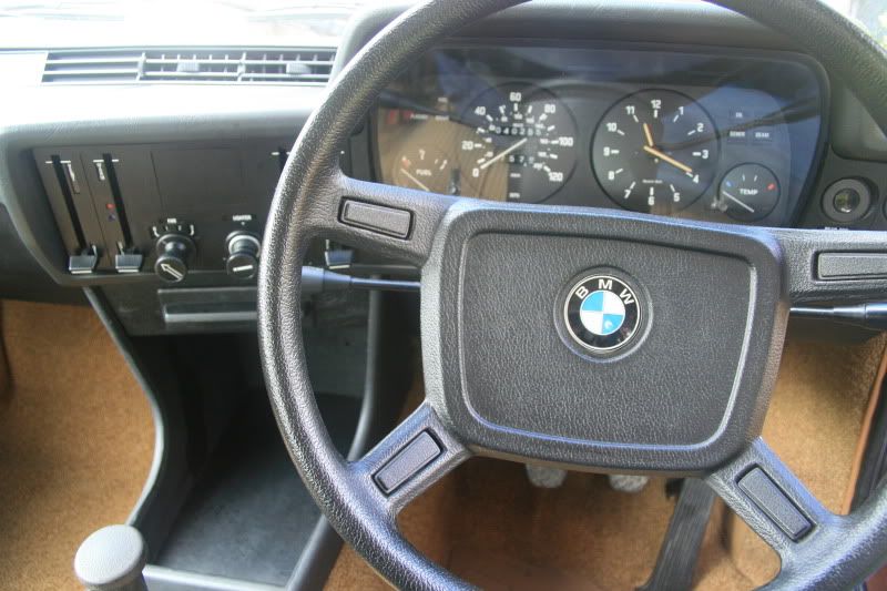

Plastic still on the back seat

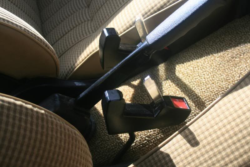

The strangest seat belt arrangement I have ever seen.

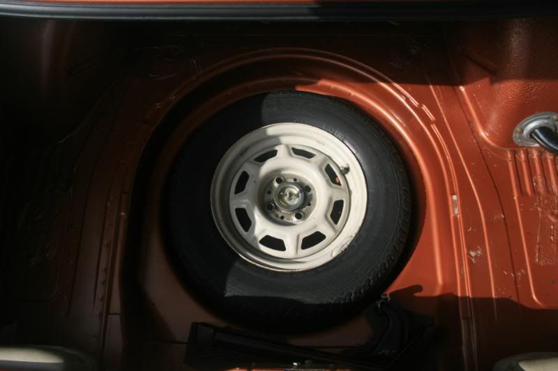

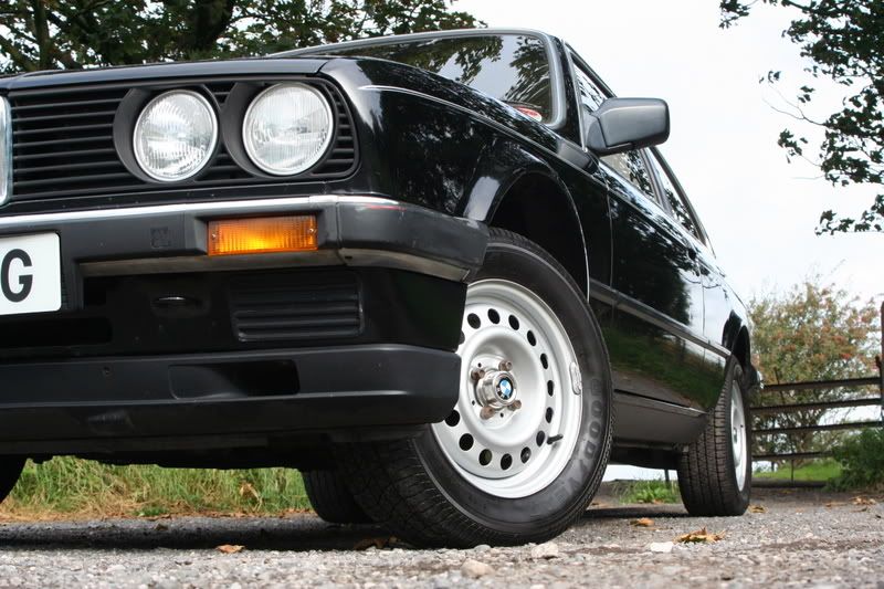

I'm not too sure about the white wheels!!

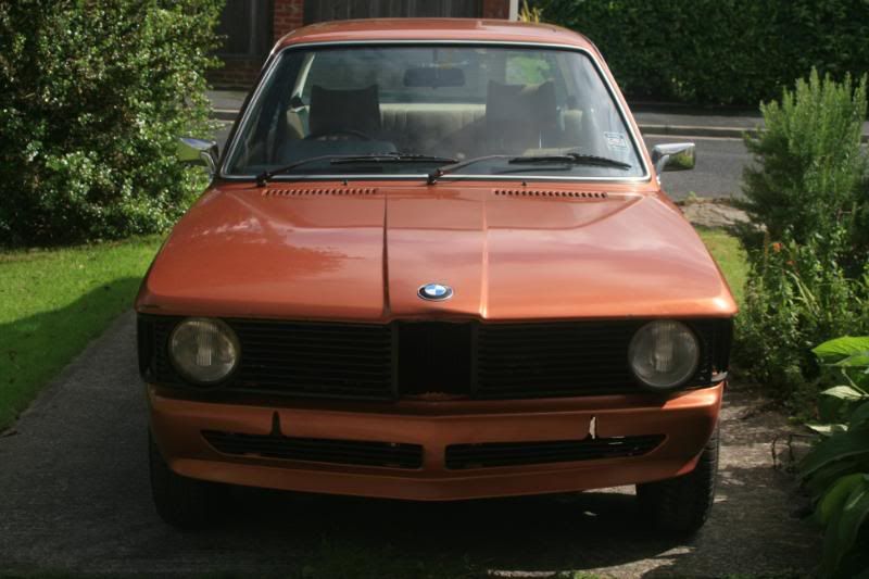

The front end is still in progress.

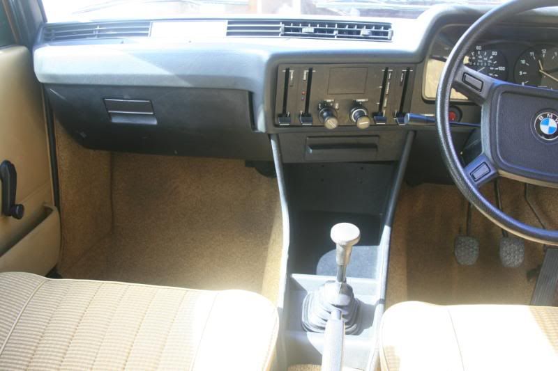

Funny things... center console without the clock, never seen. And the seatbelt locks this style are a first for me as well!

Who needs a clock when you have a 12,000rpm tach?

The good thing about the early style seat belts is that they do not have a buckle on them that can get jammed between the door and b post ....

I'm loving the seatbelt clips, I was a little concerned that when I take it to the MOT station they may tell me to change them. We will soon see :wink:
The seatbelts should be fine mate. Some VW's have that style of clip.

I am REALLY feeling this ride, glad you got this one and not the blue runner. I had a '78 Golf with the same seatbelts. Love the poverty spec dash, hope you're going to leave it like that, maybe put a CD player in the glovebox?

RetroBeemer wrote:The seatbelts should be fine mate. Some VW's have that style of clip.

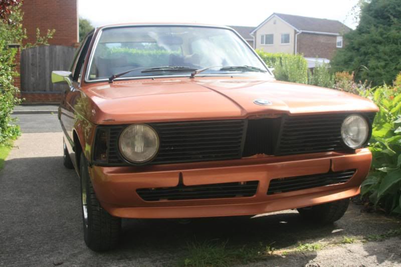

Alan
Posts: 65
Location: Lancashire, UK
Post by Alan »

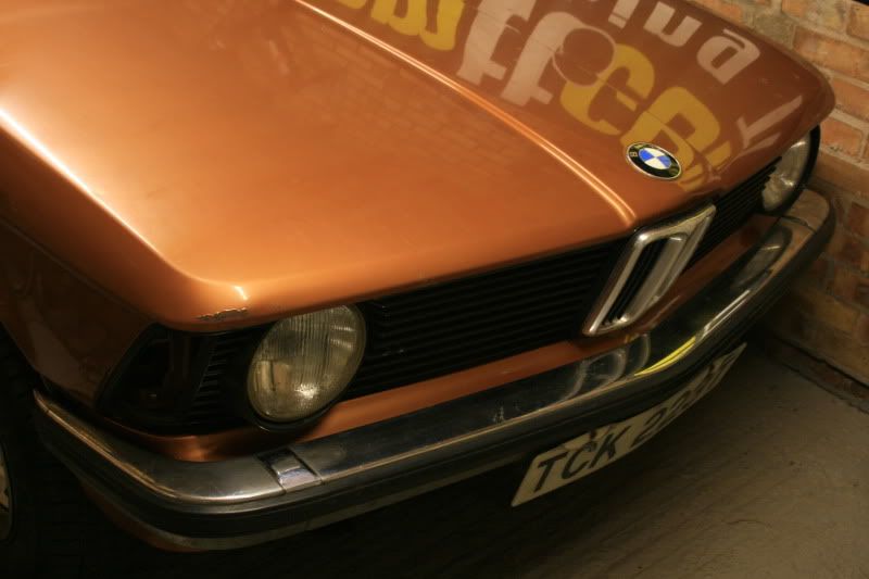

I managed to fit the front bumper yesterday. I just mounted it and nipped up the bolts for now. Its starting to look a lot better at the front end. The kidney grill is hanging on there, its off a later model so it doesnt fit correctly for now.
