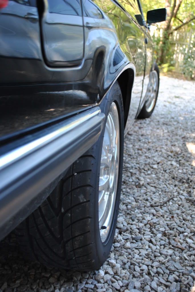

A link to my flicker account their is 26 photos totalhttp://www.flickr.com/photos/15903912@N07/4156311191/Image
Future plans to replace rear sheet metal you can see the rust and holes from old tag mount.

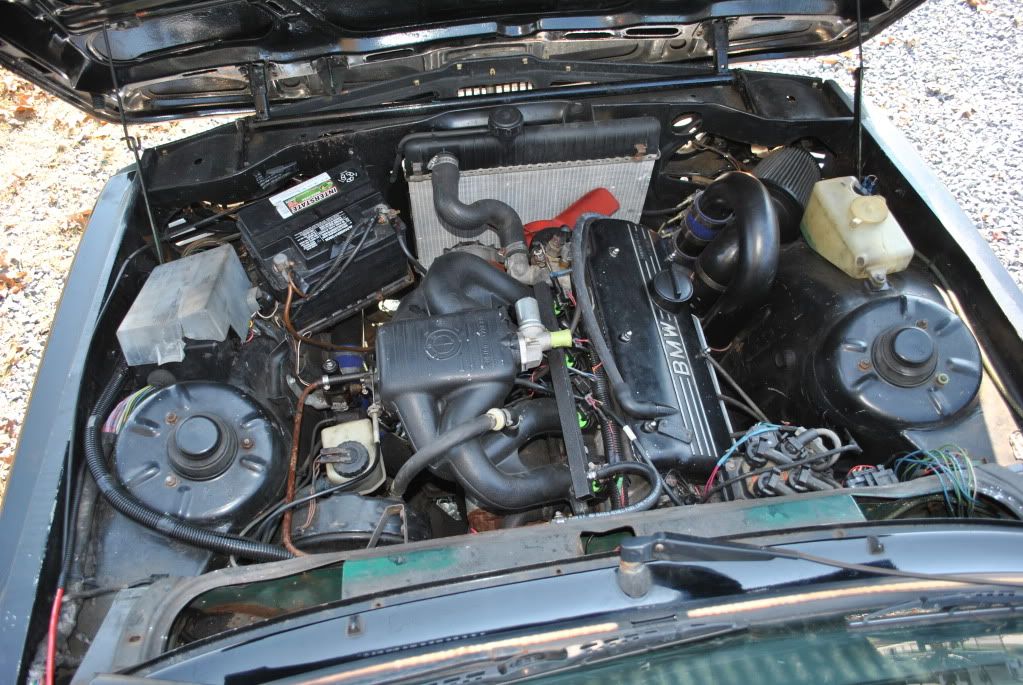

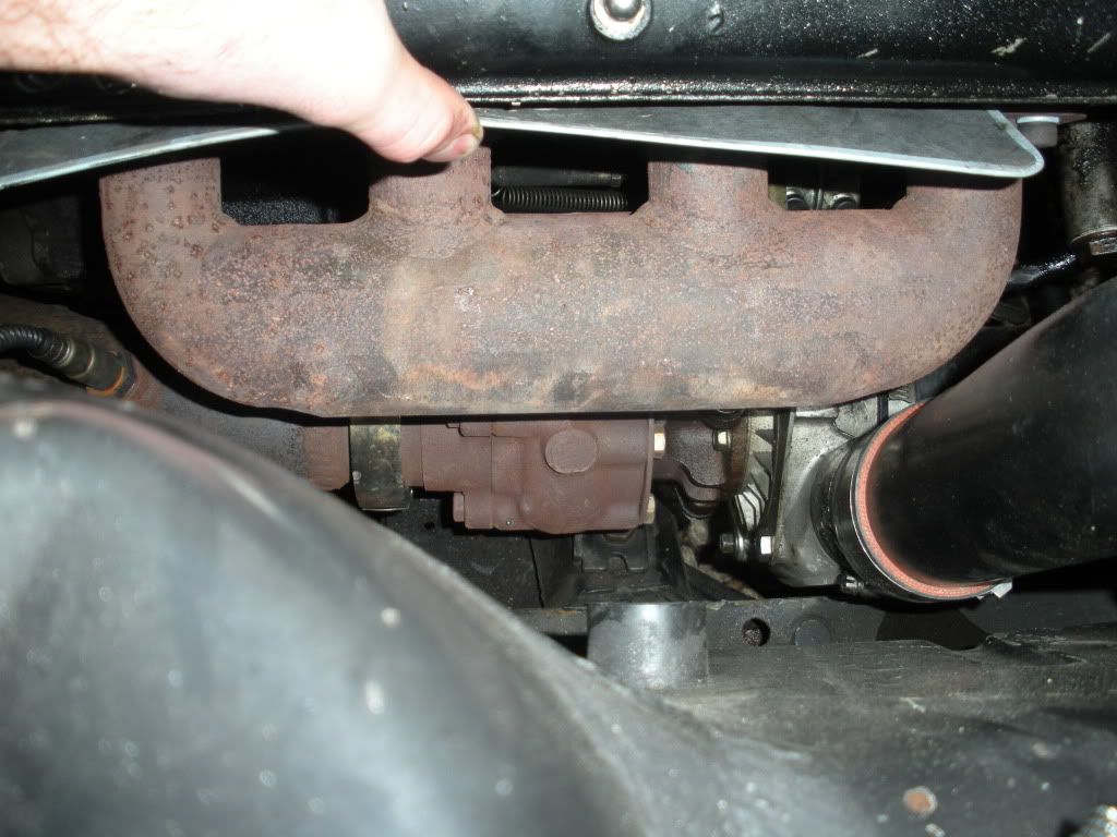

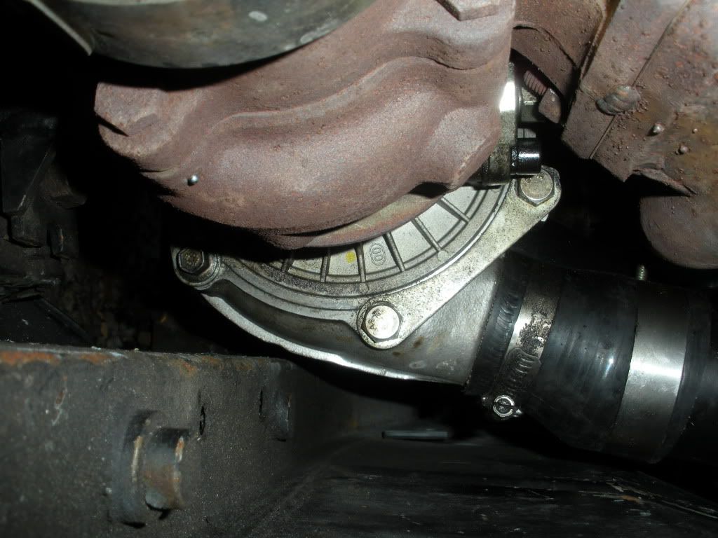

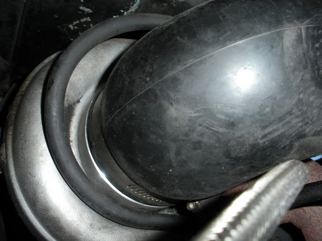

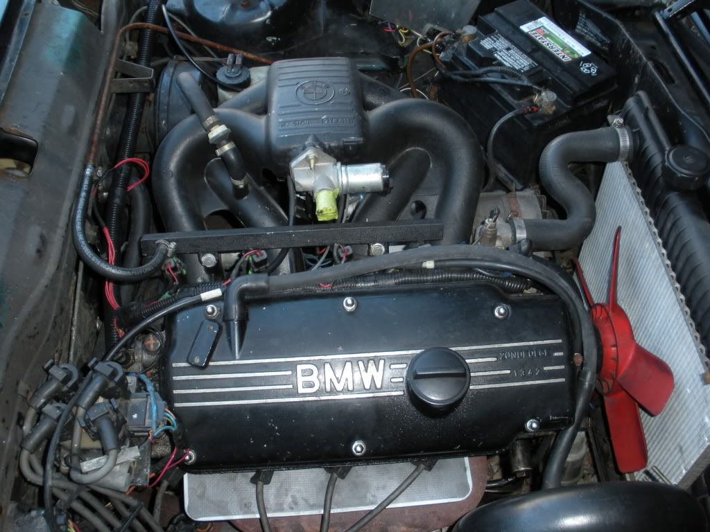

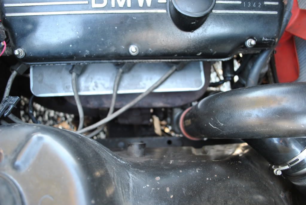

I put the turbo underneath but if i were to do it again it would go up top.
You can see how tight it is i tack weled the turbo to the maniofold because it would walk and rub the frame rail.

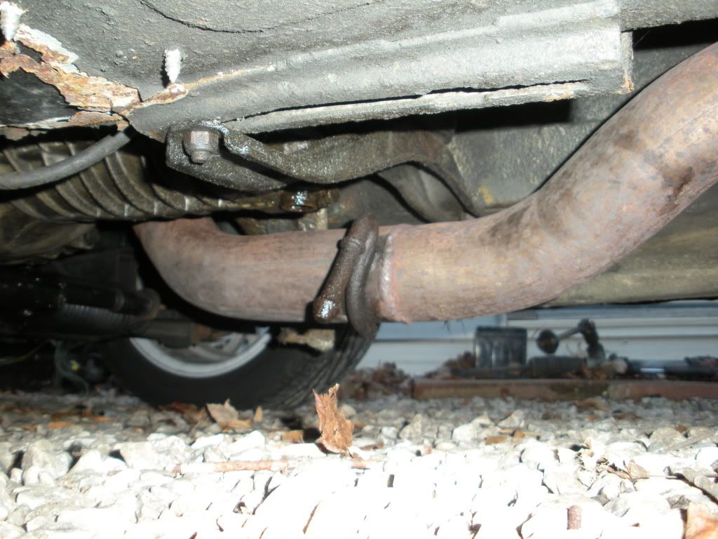

Nice rust hole in the floor exhaust made from lincoln navigator tail pipe section and v8 explorer exhaust I found in the body shop scap pile.

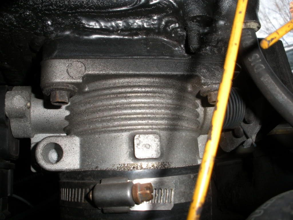

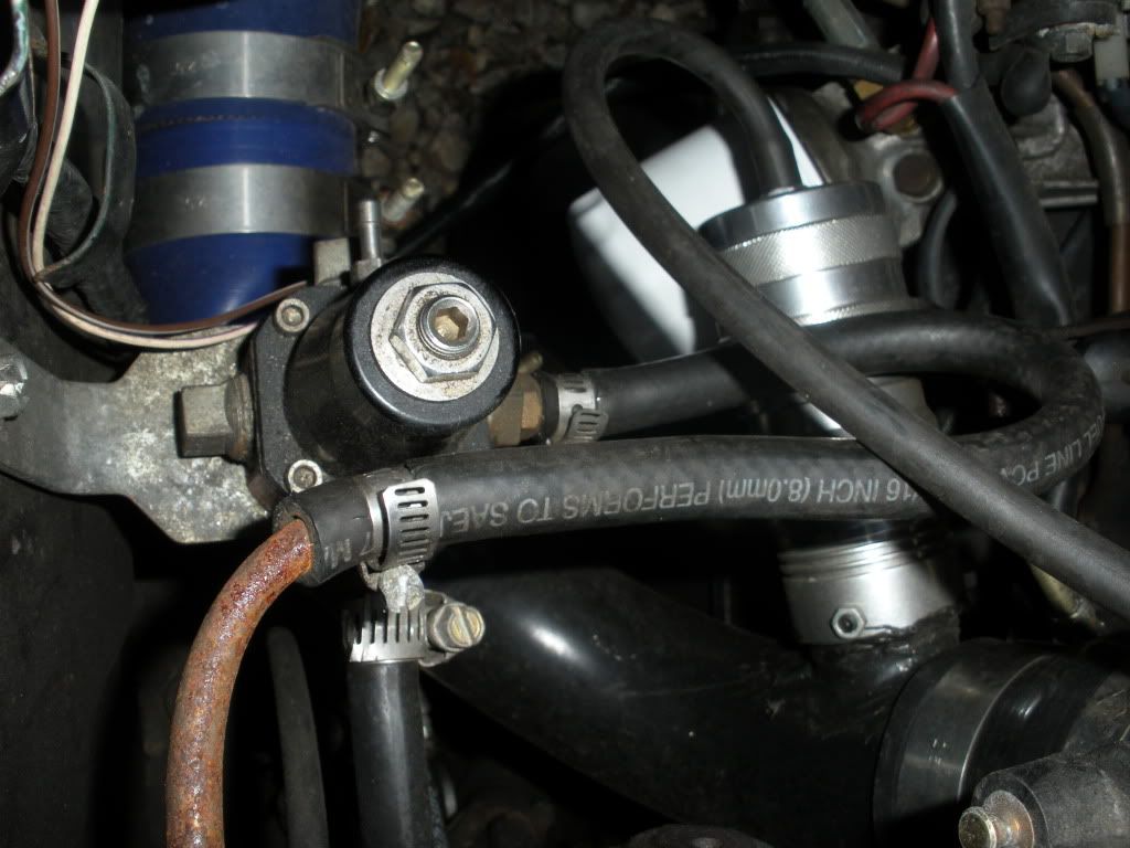

Fuel pressure regualtor and blow off valve throttle body from 4.6l Town car.
IAC valve from town car not hooked up as you can see. it would open all the way at some times
I will try to get more photos if you are intrested but the car is covered in snow right now

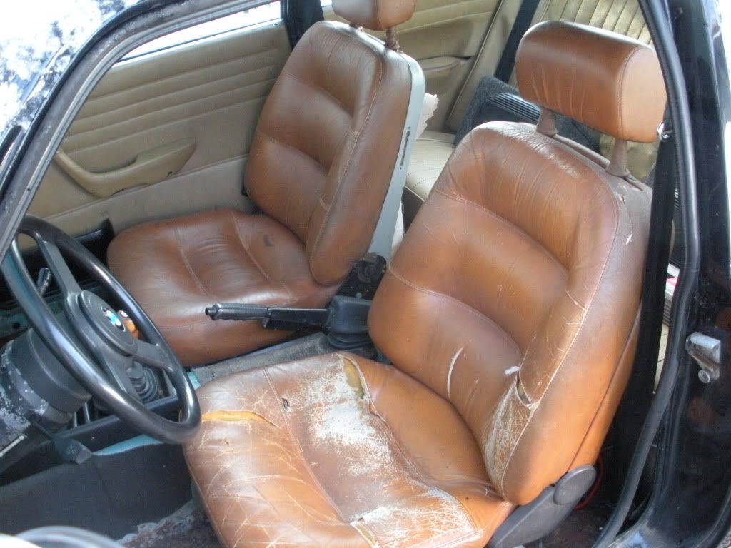

Got some more photos. Let me know what you guys think about the seats should I look for recaros or reupholster my biturbo seats? (their like a big catches mit very commfy)

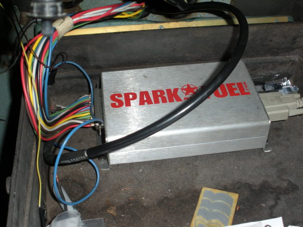

And MEGASQUIRT MSII in glove box
4.6l ford throttle body

JESUS CHRIST!!! those leather seatees you have, where they from? your living room converted on to rails?Do you suffer from a major case of piles or something??? put these in to a skip and get your self a set of car seats and forget about modifying home seatees in to cars...... those things are naaaaaaaaaaaaaaaaaaaaaaaaasty dude, what are you thinking?
otherwis all is sweet, what poundage injectors are they and from what model ford?
J
Looks a bit like volvo seats,

Thanks The injectors are ford racing 42lb's aka green tops found on 5.4l supercharged lightning. I've been looking for seats for awhile now recaros or corbeau's. But first fix the flloors and some new carpet.
The seats are from a 85 maserati biturbo

Thats actualy what megasquirt says to use plus you can pulse with modulate the injectors to cut back current and control open times. but yes it is alot of fuel I had 35lb brown top from a xr4ti but the low impedence injectors were a pain.
Megamanual.com has a section on turbo charging it has alot of info.
