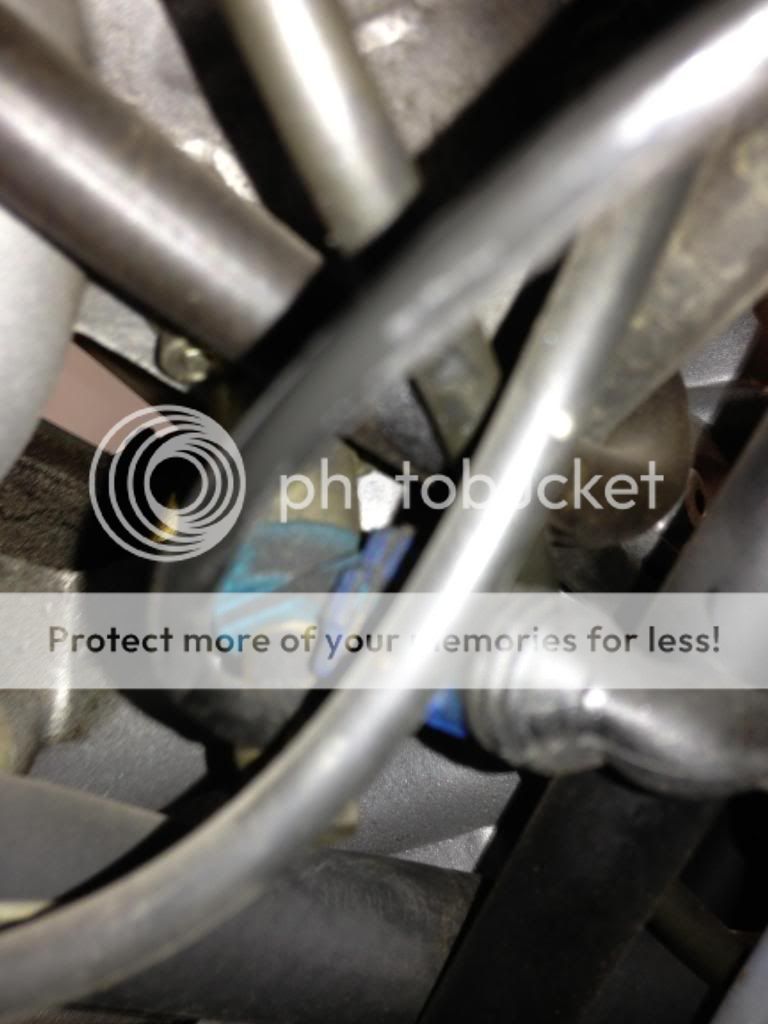

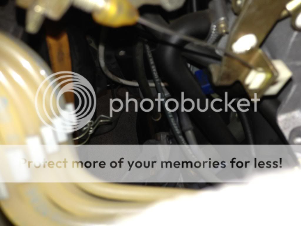

Tried to disconnect the AUX (if thats the one on the pics with a blue connector you refer to?). It does something as it reacted by running very bad when cold. Put the connector on again and it ran fine again, but only for 2 mins. Then bad idle again untill warm. Now you mention the thing with the cold start rpm. You do have a point. Sometimes the rpm comes up, sometimes it don't. When it does it is usually after 2-3 min. of running and only for about 1 min.
Think I'll replace the unit at once unless it is easy to clean and adjust?

As far as I can see that's the cold start (extra) injector. If it still influences how the car is running when warm it may be an issue as well, leaking fuel inside the intake, of injecting when it shouldn't anymore (defective thermo time switch). You can remove it to check but make sure to have a new gasket for it first. And you can first measure if it is switched measuring power at the connector, that doesn't require removal of the injector.
But the aux air valve is closer to the firewall. The electrical version looks like this:
