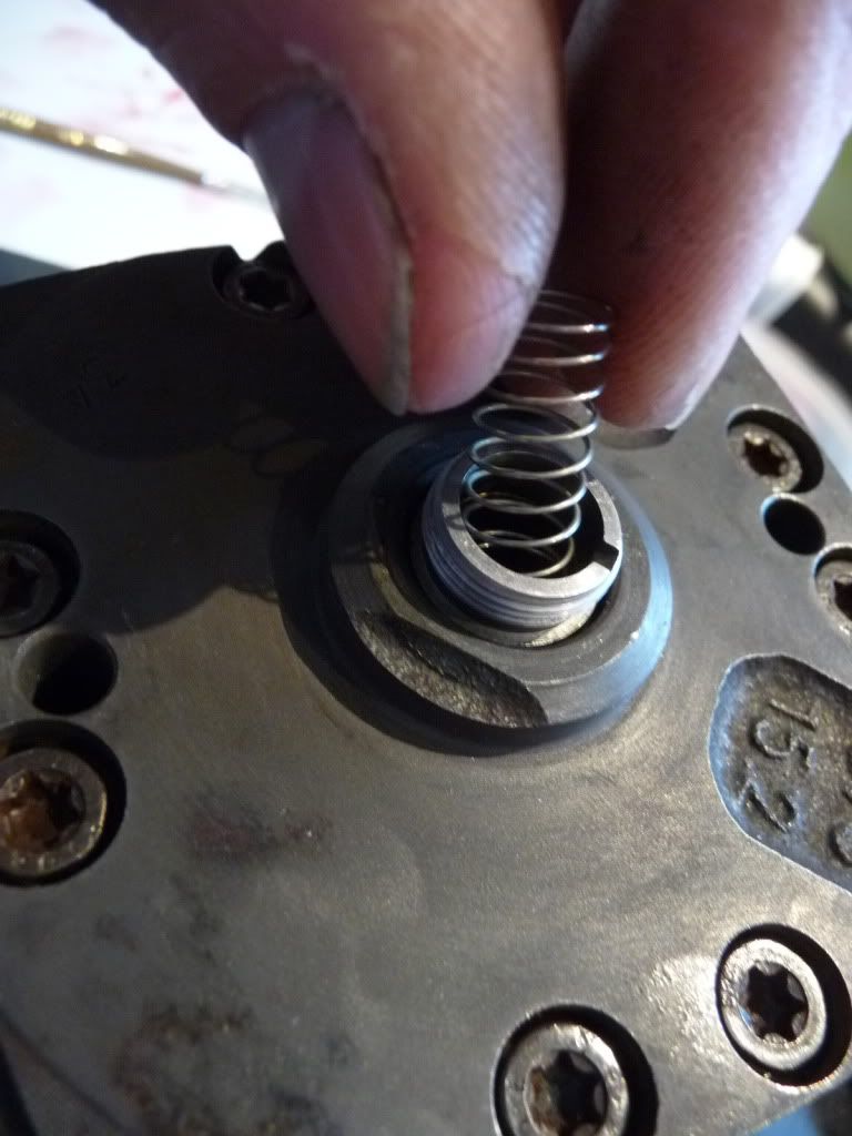

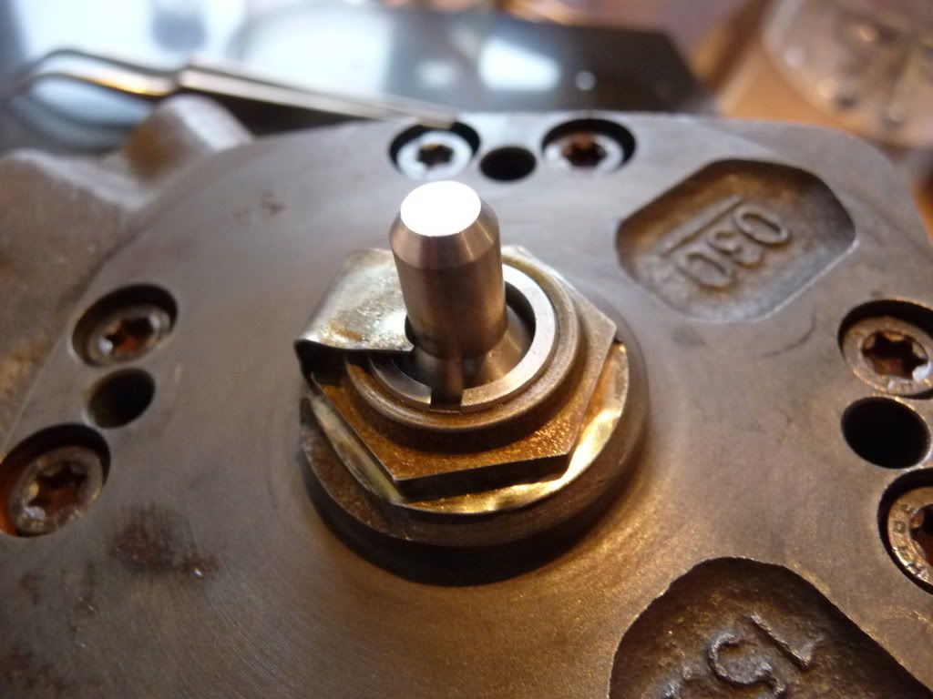

i took the metering unit apart today and as you guys suggested the piston was gummed up and stuck in the bore at the wide open throttle postition.
having sorted that out, the car runs significantly better, 5 cylinders are perfect, one is missing. so i have a new set of leads coming. and a distributor cap.
i am having a hose made so i can set up the warm up regulatr pressures etc. will keep you guys posted.
