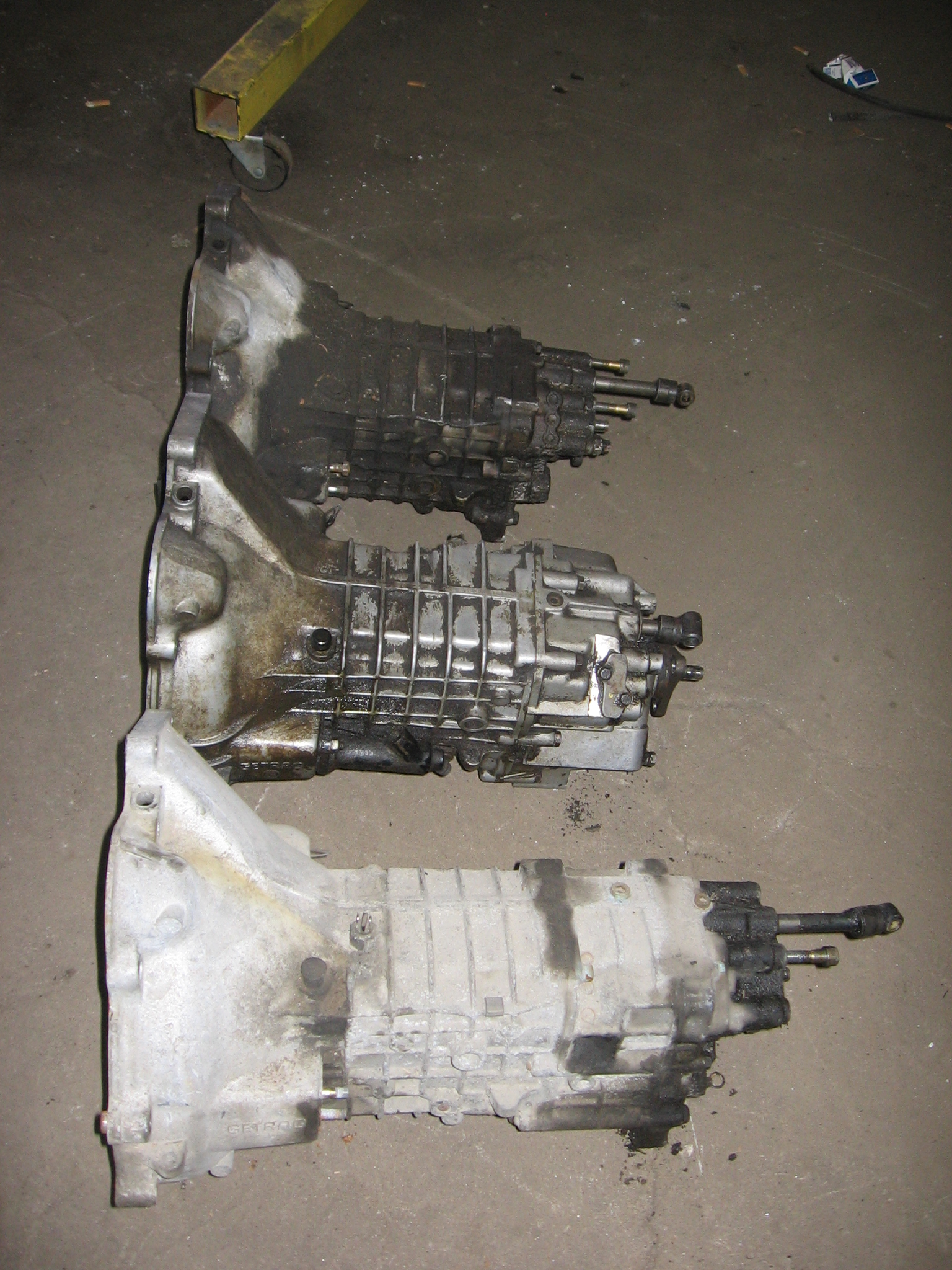

Early e21 4-speed. Not 2002,clutch slave cylinder is different. Some parts are "same casting" 232 vs. 242 and thats why those both have 232 castingmarks.
Latest m10/m20 5-speed 240-Getrag have bigger "ass" than 242.
245,240,242 in pic.
