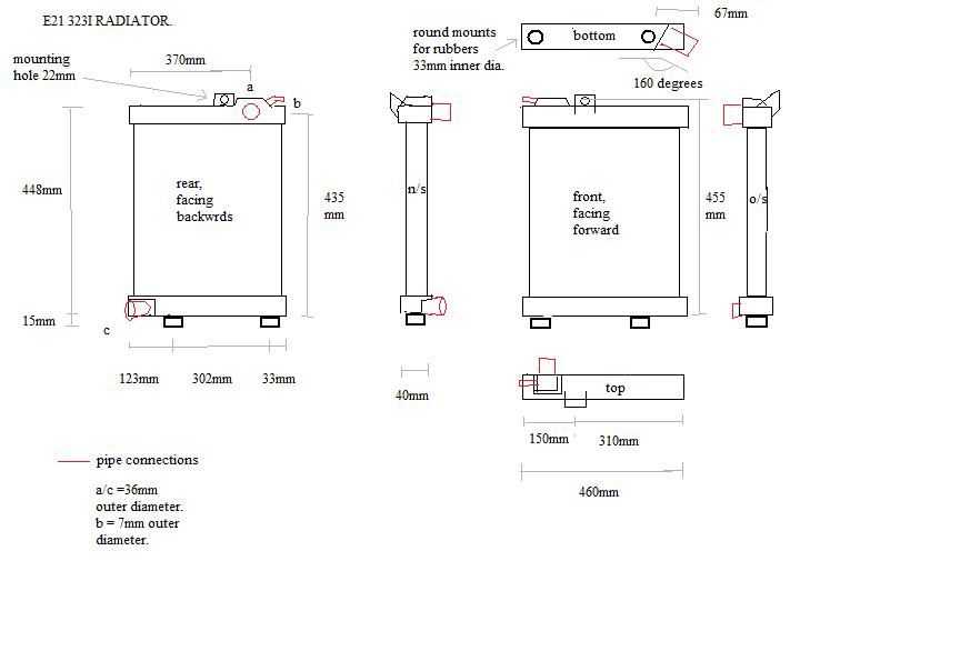

as of a few days ago.... ive been in contact with a company making ally rads/silicone hose kits and stuff via email reguarding then making a direct replacement ally rad for 6 cyl. e21s. they seem more than interested in adding it to their range...... ive sent them a diagram with detailed diamentions and some photos of one of my leaky rads. waiting on them getting back to me on a unit price and time scale.
looking at their other rads on their ebay shop it'd be about £130-£150.....
its a chineze ebay based seller http://myworld.ebay.co.uk/chracingradiator
im thinking group buy here to bring it down a bit?
does anyone else make a replacement ally rad?
waddu fink?
