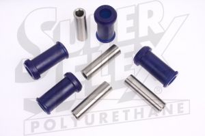

Why do the OEM bushes and the superflex ones look so different??
Image vs. Image

Bushes for the rear trailing arms aren't that different but the tubes are shown separate on the superflex pic, these are inside the oem ones as well.
