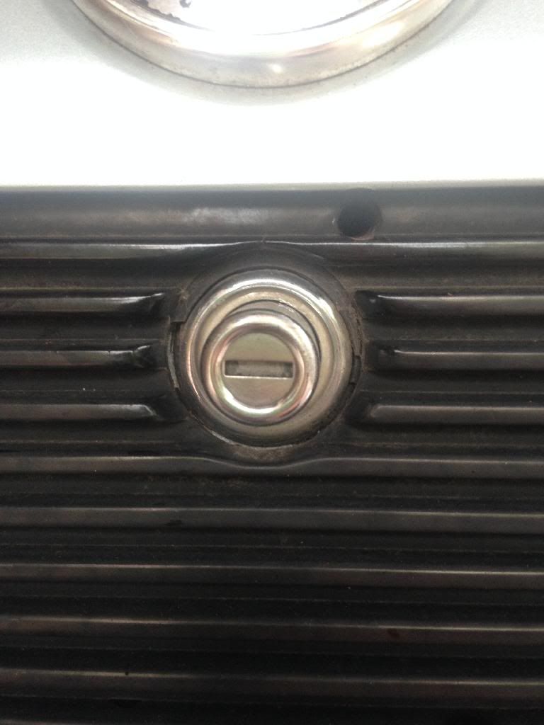

for anyone else who locks keys in boot, drill a hole, approx 6mm, in this exact location, then a with a small screwdriver you can manually press the latch forward which will open the boot
