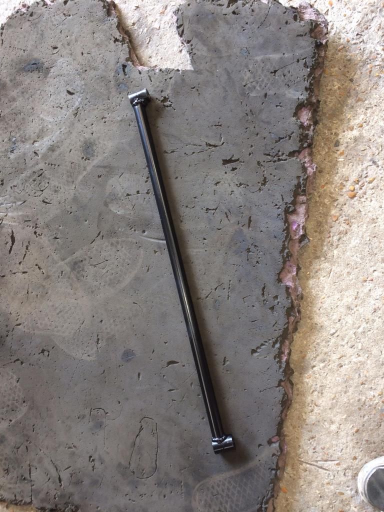

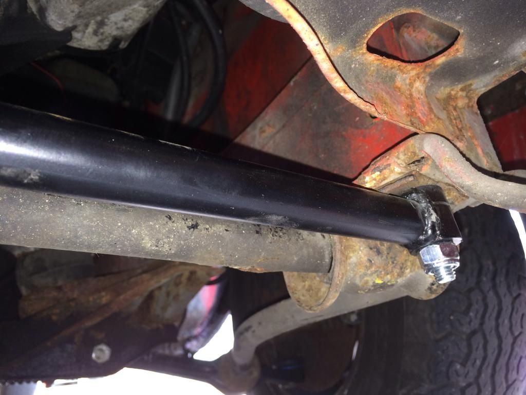

+1 with all above haha, nice upgrade installed right away, should do a crash course on welding myself some day
