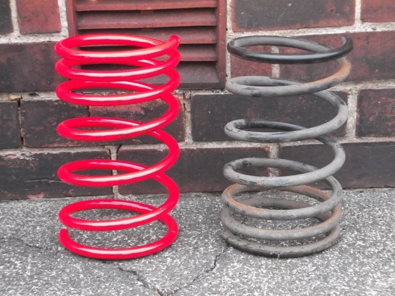

I have fitted a set of Spax springs & adjustable gas shocks (40mm drop). Seems to work well. I still have the old H & R springs I took off.

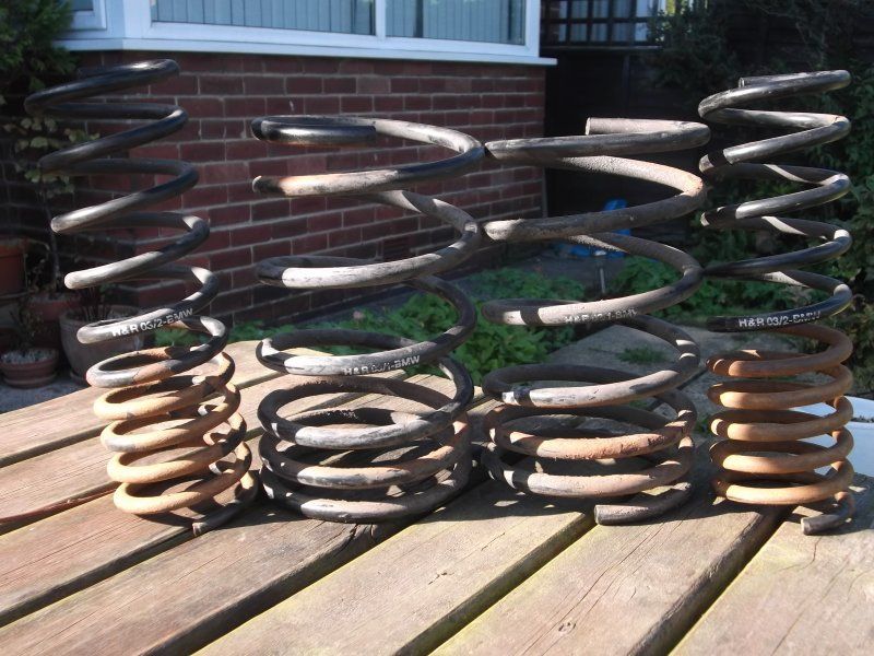

I'm sure I found mine were -40mm when I Googled the numbers on the springs.
Old H&R with new Spax PSX
