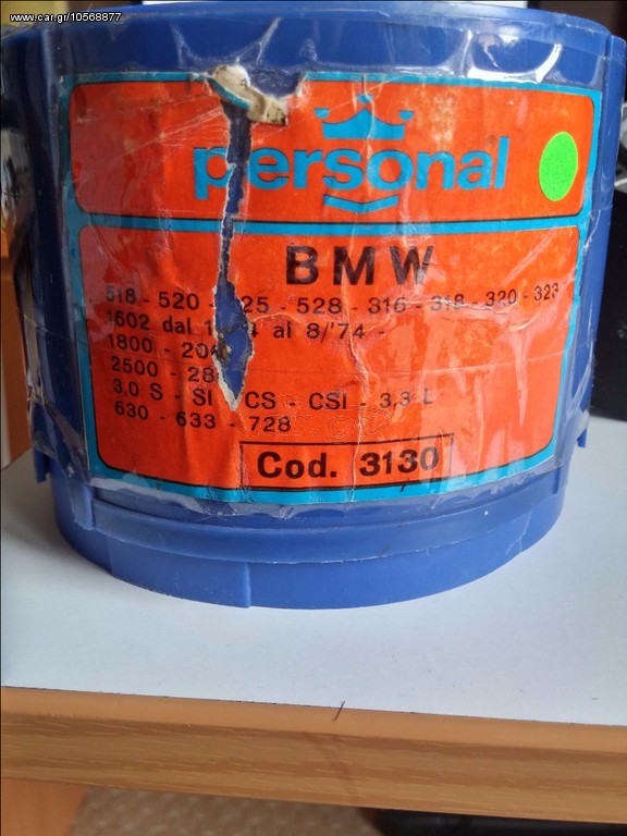

Last but not least a steering wheel question. I have a nardi wooden steering wheel and a personal hub. Image
The hub however is short and as a result when i am driving there is not enough space between the steering wheel and the switches for the turn signals and wipers, for my hands. That's why i need a taller hub. After a search i found those two:
http://www.ebay.com/itm/BMW-6er-E24-M63 ... Gy&vxp=mtr
http://www.ebay.com/itm/Luisi-Italy-Ste ... XR&vxp=mtr
The problem is that i can't find any dimensions. Anyone knows which one is taller?
