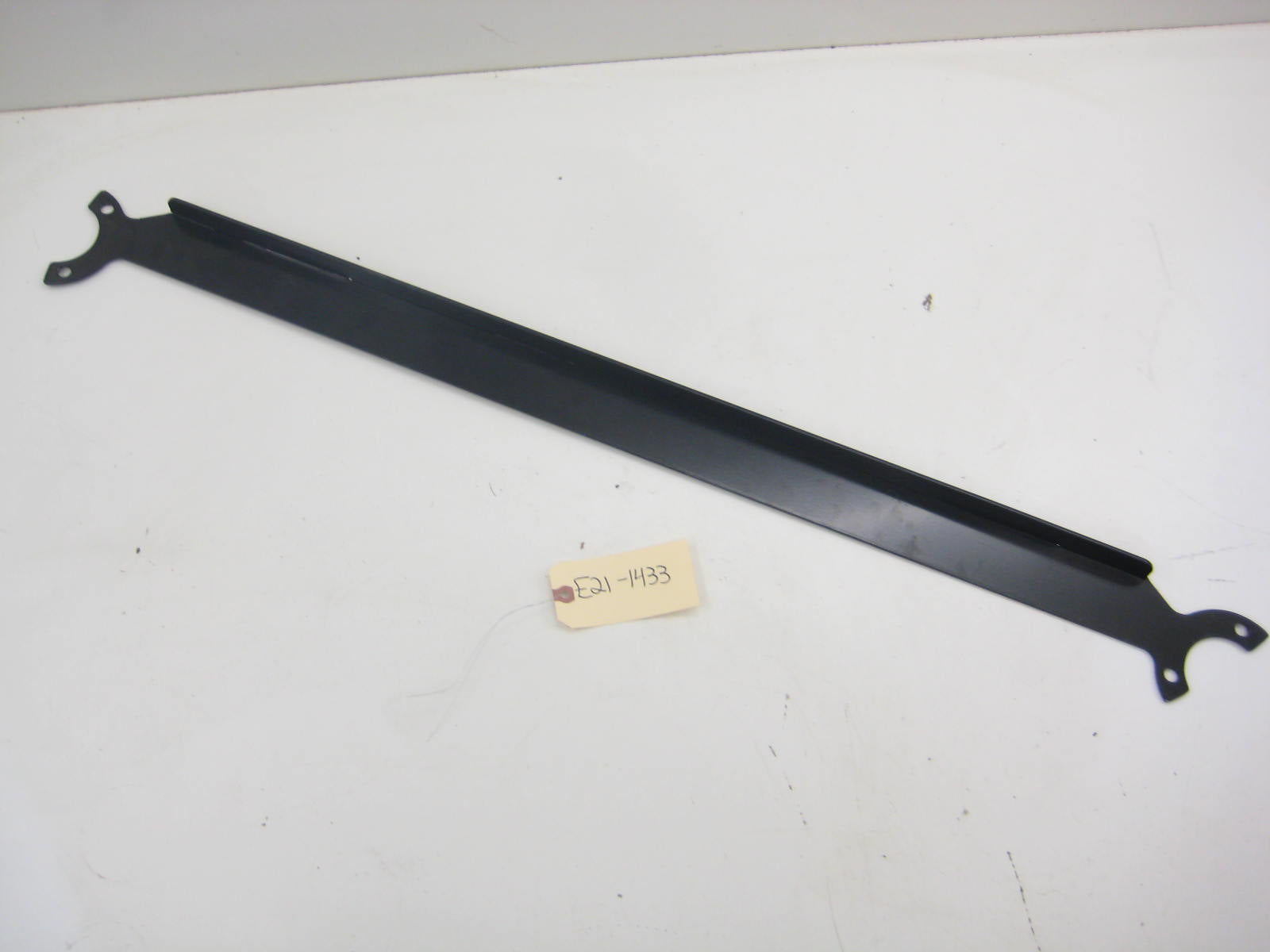

Don't have any pics I'm afraid. The basic steel and aluminum ones on their website are clamped around the strut tower, they require drilling 2 holes and you have to remove both struts to fit them correctly. The one in the picture you posted seems to be a generic one, or also requires drilling as the spacing appears to be too small to use existing bolts.
I do know there are other strut braces that are fitted on top of the strut towers, using 2 of the 3 existing nuts on each side. These do not require drilling or strut removal.
Found this one from Classicdaily but it is discontinued, must still be others though

That looks easy to make, but what is its purpose?
