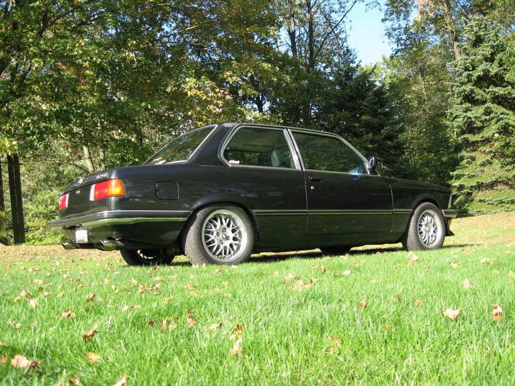

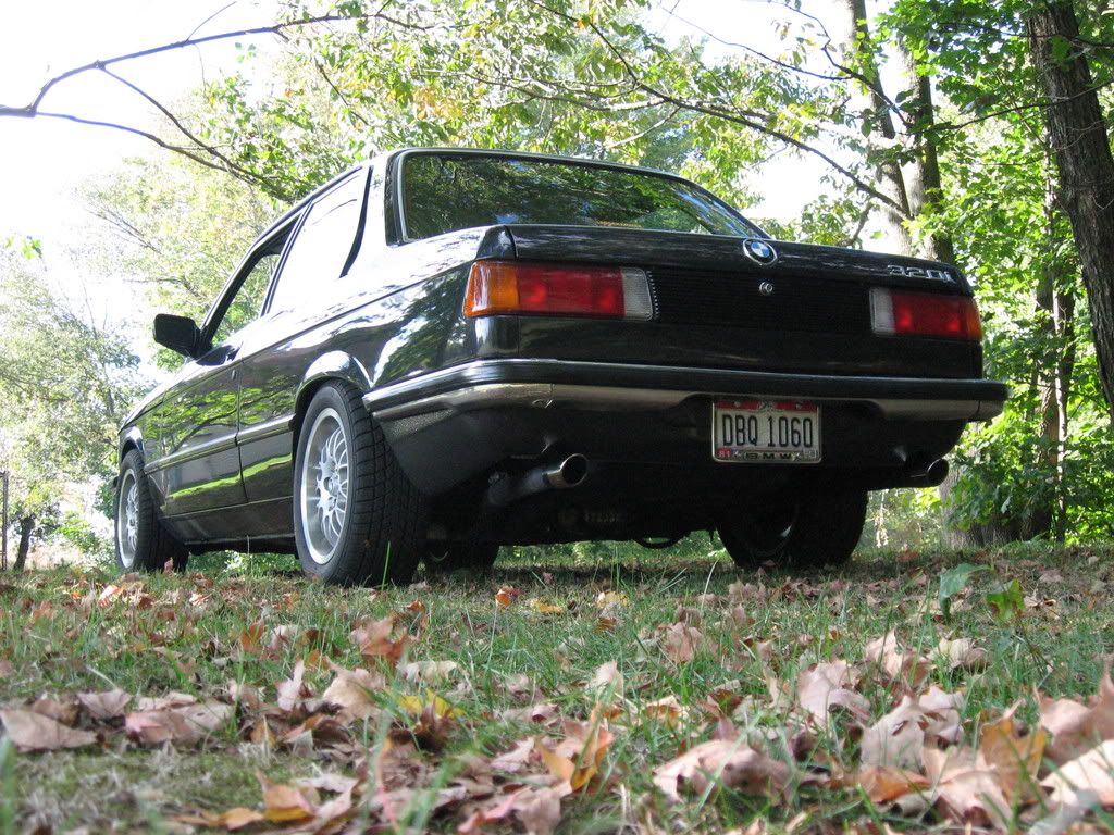

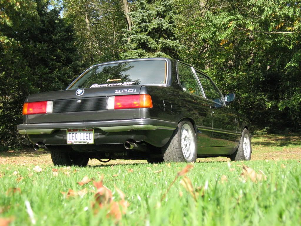

Great work and good photos.

Graet work, really great work and with the 323i exhaust it's goona be perfect!!!!!!!!!!!!!!!!!!!! Thanks for sharing.

Mcinek wrote: Graet work, really great work and with the 323i exhaust it's goona be perfect!!!!!!!!!!!!!!!!!!!!
Finished:

very nice car!!!

Bloody amazing. I am VERY jealous!

Thats amazing !!!!!!!!!!
Im lost for words

It's perfect :) Verry nice work!

Nice car
Congratulations :D

I love it...
That is a dream car...
