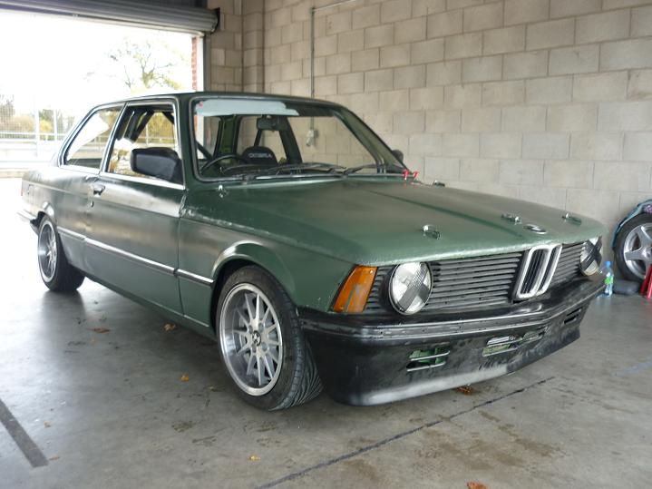

Well, the longer wheel bolts arrived yesterday so today I set about fitting the front wheels. Got them all fitted, looked good & clearances seemed ok, set it back on the ground & tried to move her forward..... Little grinding noises ensued so I re checked the front & found that the track rod ends were grinding a little :( there's now a 1mm deep furrow about 1/3 of the circumference of the inner wheel :cry:
They are touching too much to leave so I have removed the front wheels & ordered a set of 30mm spacers, I'll take the 20mm ones off the rear, put them on the front & put the 30mm ones on the rear. This will give me plenty of clearance & the wheels will sit nice in the arches.
Effectively I'll have 15 x 8 wheels with -5mm offset in the rear & +5mm offset in the front..... Need to save for the coilovers next month but will hopefully have them on by the end of Feb. I'll post some more piccies next weekend when I get all the wheels on & my brackets for the seats should be done by then so I'll fit them too.

Seeing as it's above freezing today (A whole 2degrees :D ) I decided to swap the wheels & spacers to finally see what it looks like with the Schmidts on & I must say that I really like the way it looks. I'm happy with how the wheels fit in the arches, it just needs seriously lowering now. Anyway here are the piccies I took
Front fitment
Rear fitment
And how it looks now
